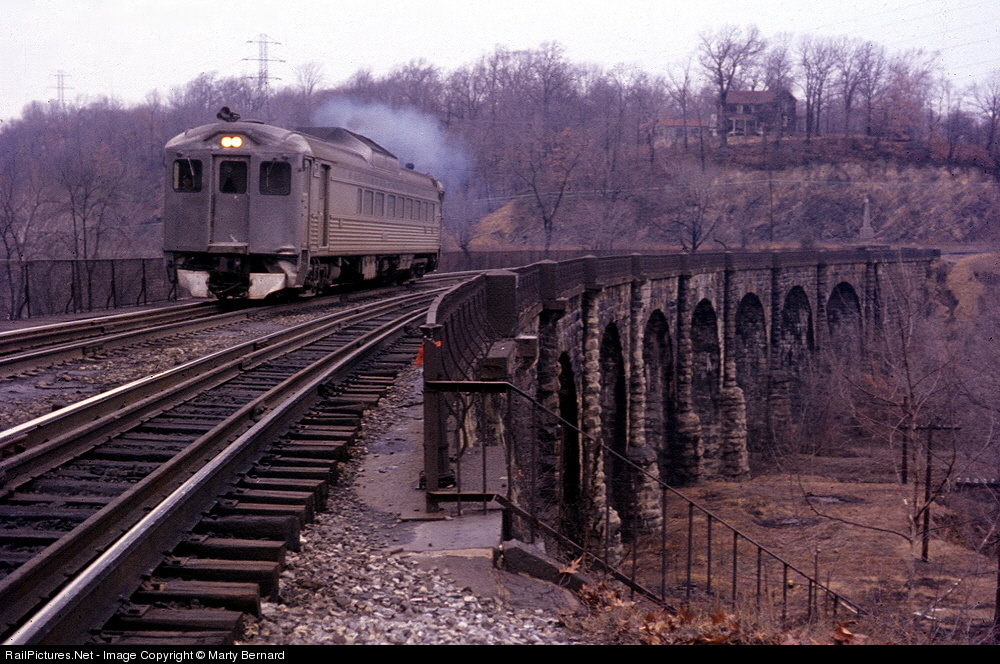

Thomas Viaduct, on the B&O near Baltimore, is a stone viaduct built on a curve.
