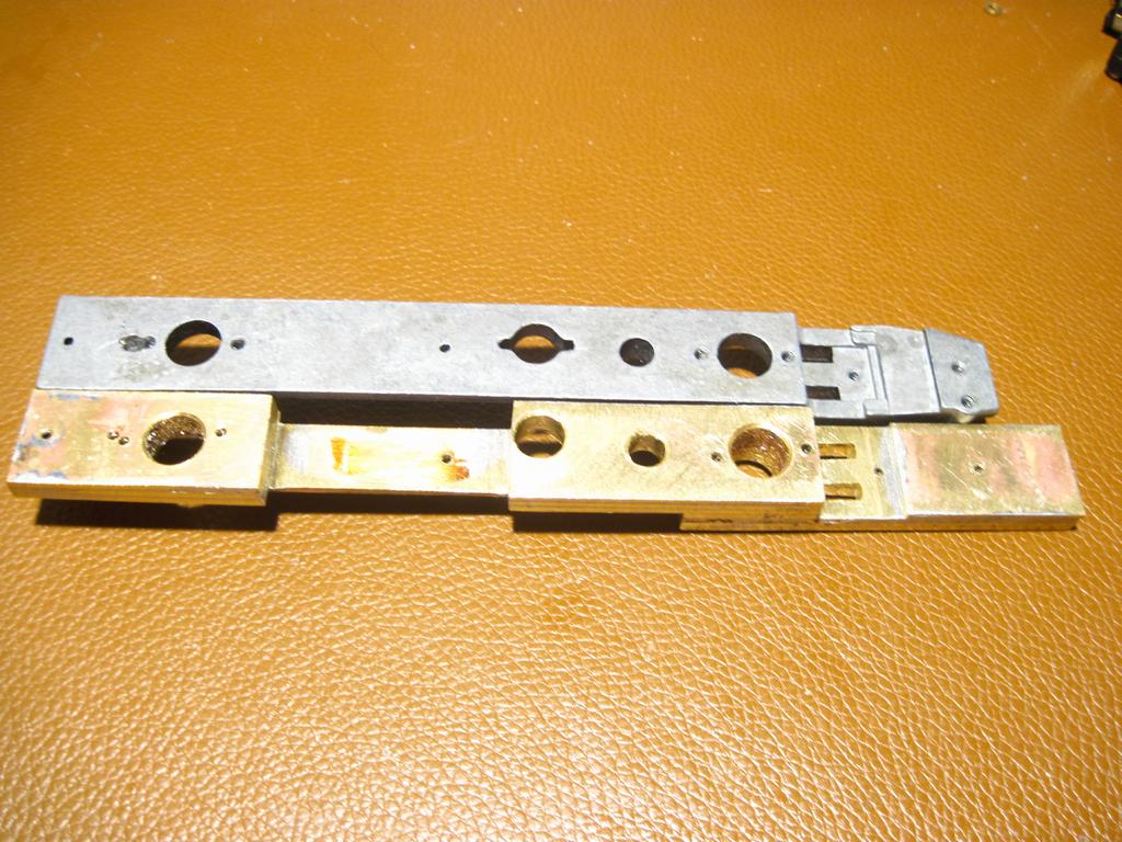

If you can work with brass make a new frame for it. I make replacement brass frames for my Rivarossi articulateds. I prefer dual motors in my Cab Forwards and I have built four so far and I’m presently working on five and six.
This is a brass replacement frame next to the original Rivarossi frame.

I have made several frames for older locomotives that had cracked from Zinc Pest, it really isn’t that difficult. I think every hobby shop s
