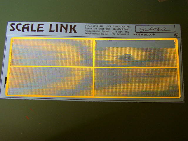

I used etched brass barbed wire for my fences - available from Scale Link in the UK.
Once it is twisted between the fingers it looks pretty good, and could easily be wrapped around a pencil for other effects.
Here it is on my layout, Sweethome Chicago
