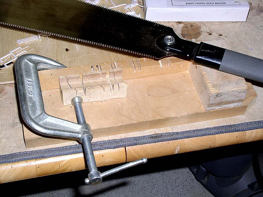

Two pieces of luan plywood, 1" x 6", and one six inch 1"x1", make a U, flat on one side. Pin nailer and glue worked fine for me.
Two foot 1"x4", a two foot 1’“x1”, nail-n-glue the one by one to the top of the 1"x4" flush with one edge, put the guide away from you and nail a two by block to the right end for a stop.
Clamp part A to part B against the guide, draw a purty square line and 45 degree line, then cut both with a Jap saw (Vaughn makes the best, “double teeth” side works the best, 20 bucks).
Voila, instant miter box, cost $20, and the enterprising can figure out how to use this jig for sanding them square too. (Hint, begin with a rectangular block and adhesive sandpaper.)
