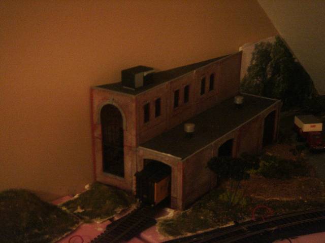

This doesn’t exactly fit your situation, but it illustrates a couple of points. I built this from DPM modular sections, and added an interior mostly based on photos:
First, the structure is involved with the railroad. The siding actually enters the building. In this case, it’s more of a shelter, but it allows the building to be larger yet include the the siding. You can see the cars through the arches.
Second, I placed this diagonally, not flat, against the background. The angled placement adds depth and interest.
