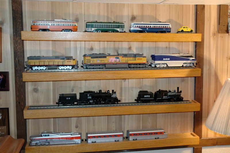

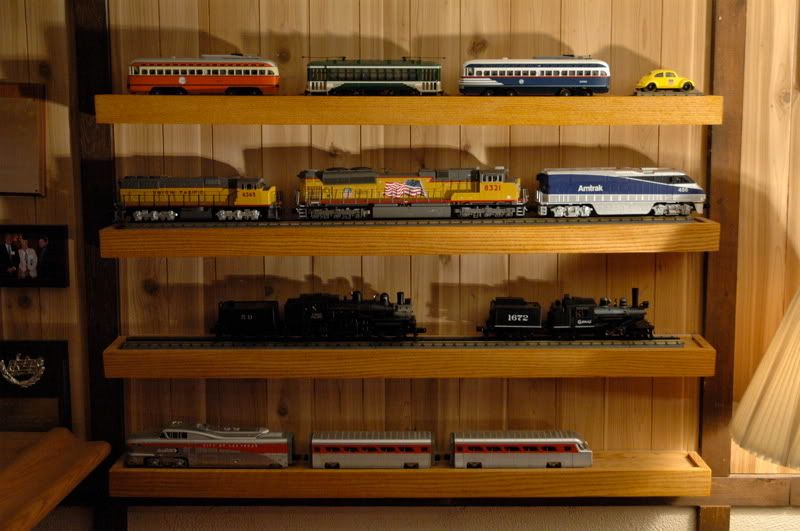

My oldest son made these shelves for me a few years ago, he never took any woodworking classes in high school but was drawn into woodworking as a hobby after he finished college. He has done some amazing projects and I was VERY pleased to accept these. What was really neat was that we had an Oak tree die on our property and we saved the longest part of the trunk and had it quarter sawn, lots of board feet for his shop.

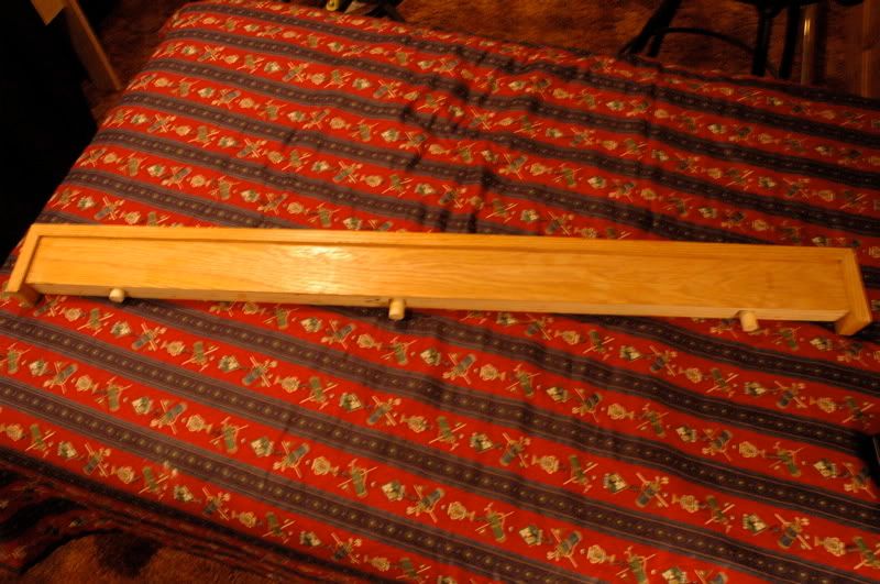

Here is the detached shelf, notice the square holes and round pegs

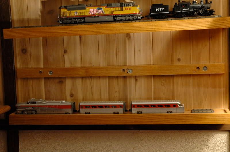

Here is the receiver board anchored into the wall, that was a royal pain

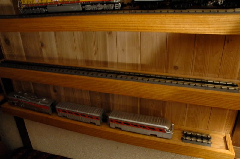

Empty shelf w/track, you wouldn’t have to have any track
Shelves w/no flash
Shelves w/flash

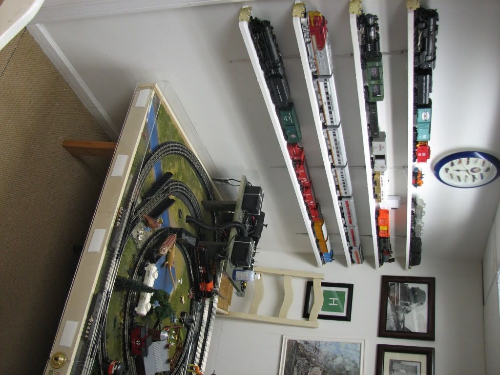

I’ve mentioned this before: I mounted 36-inch K-Line O27 track on plywood using corner braces. Besides being cheap, it blocks very little of the view of the trains.

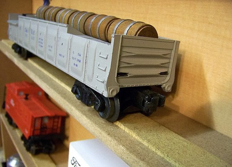

I built shelves on the cheap using a sheet of 1/2" MDF cut into 3 1/4" strips for the shelves. The backing to the shelf unit is a piece of 1/4" hardboard. The MDF shelves are nailed and glued to the ends and through the back. MDF is a type of compressed wood product and is not very strong so it must be supported by attaching it to the back. Instead of cutting grooves in the shelves, I cut strips of 1/8" hardboard 1" wide and glued to the center of the shelves.
One advantage of building an entire unit to hang on the wall is you don’t need a lot of attachment points. Mine is held on the wall with 2 screws.

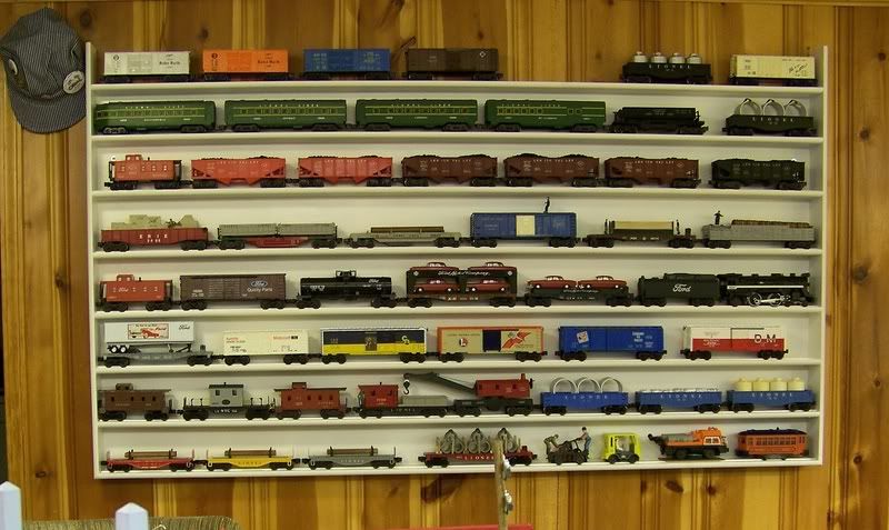

I have one unit that I varnished natural and another that I painted all white. I noticed that I liked the white unit better because it shows off the trains more dramatically than a darker color, just look at all the shelving photos on this list and compare the wood shelves with those that are white or with white background.
