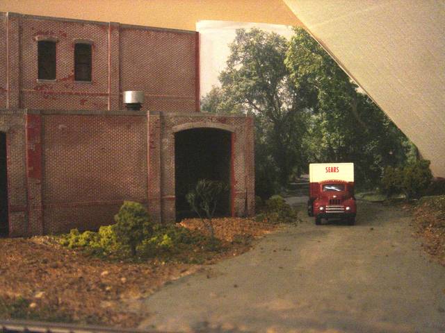

DPM Modular sections are another option. This building is made with DPM parts:
I also use the Walthers brick sheets. (I work in HO scale.) The brick pattern is it bit shallower than that in the DPMs, but not enough to notice. After painting and mortaring the brick, the difference is hardly noticeable, so you might want to combine the the two products. DPM gives you a nice, quick way to put in arches, doorways and windows, while the brick sheet is much less expensive on a per-square-inch basis.
