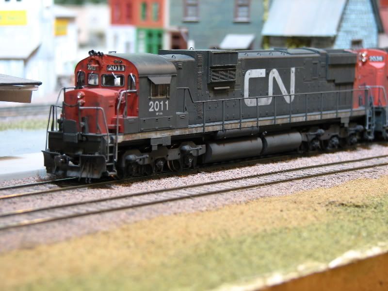

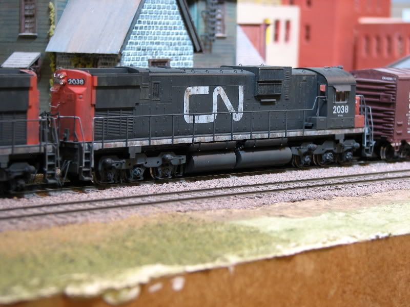

Here are a couple of shots of my CN C630’s. These are Stewart models with Prototype Model Industries Dofasco trucks.
Nice work - I have one of the PMI truck kits to turn a Stewart model into an ex-CN unit, but haven’t started yet.
I’ve also got a set of the later disposable-filter aftercooler intakes from Jay’s Train Parts. Tiger Valley makes that component too, and he sells parts separately at very reasonable prices. Between Tiger Valley, Jay and a few other sources, there isn’t much you can’t get to build an accurate C630M.
