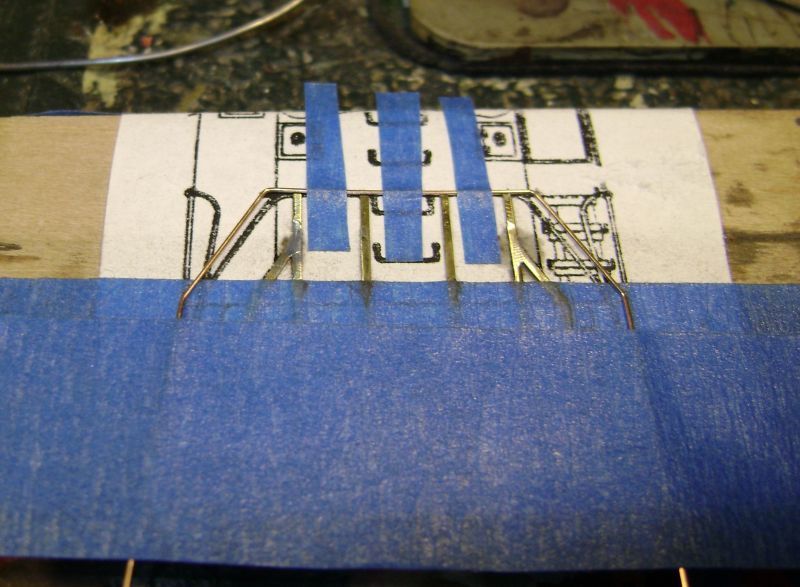

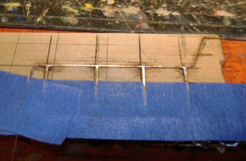

I also use a piece of balsa wood to layout a drawing or photocopy of what I’m going to solder, then bend the wire following the diagram (which has be glued to the balsa with Spray Mount). Then I tape all the pieces down and solder everything together. I use flux, you can use paste flux (from RS) or Tix liquid flux, (from Micromark). Be sure to clean with some iso alcohol and a stiff brush when you’re done.
Do not use CA in the joint that you’re going to solder, when you burn it, it wull leave carbon deposits that won’t take solder, you’ll end up with ugly weak joins.

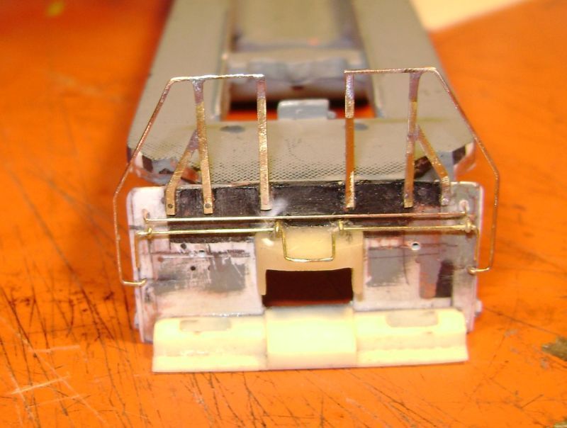

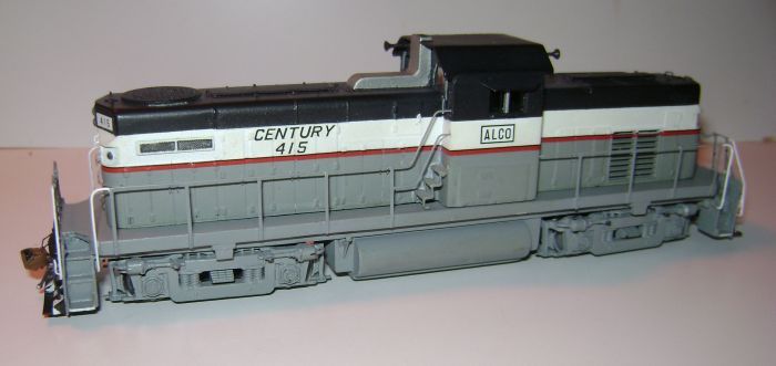

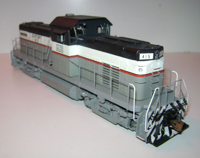

Here’s a couple of pix from my ALCo C-415 build (see link below):
Before clean up
Finished model
