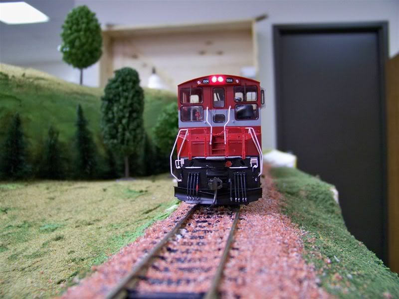

With such large windows but no crew inside! Can anyone tell me how to remove the cabin from the body shell. Where to apply pressure or what-ever in order to seperate the two.
It’s not too bad. This is a Genesis MP15AC, but the SW1000 should be similar. Gently pull the rear handrails out from the cab. With the body off the frame, push on the tab on the front of the cab. Should come loose.
