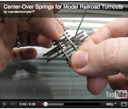

Another option is to install home-made center-over springs:
