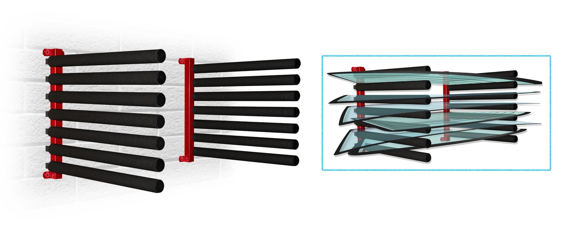

Having an HO layout outside gets old real quick. A friend did this instead and it was a good solution.
Have you seen the walls of a car windshield repair shop? The windshields are stacked up the walls on racks.
My friend made something similar out of 2" x 2" that held 2’ x 6’ and 2’ x 8’ lightweight modules of layout on the wall of his garage. In good weather he would set up on the patio, driveway and even in the house or garage at times. He could use any combo of the benches as the track crossed the ends in the exact same spot on each module. He also had smaller corner modules.
His wife went home to England for a month once and he had it set up in a big circle that went through the living, dining, kitchen and down the hall to make a large circle. He was in heaven. :laughing:
He would bring into the house a single module and work on it when he wanted to do landscaping and stuff. Most were 6’ and easy to handle.
