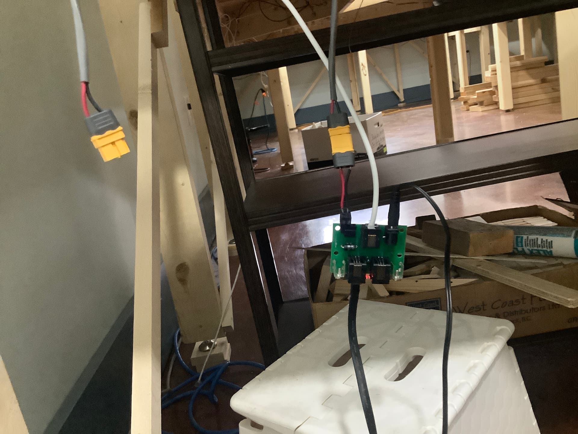

So this is how i had my power panel hooked into the layout. Notice i had the little black track power wires only half hooked up. I made that little kinda adapter to quickly move from powering the programming track to the main layout power. To make sure i didn’t make that mistake that you all talked about.
