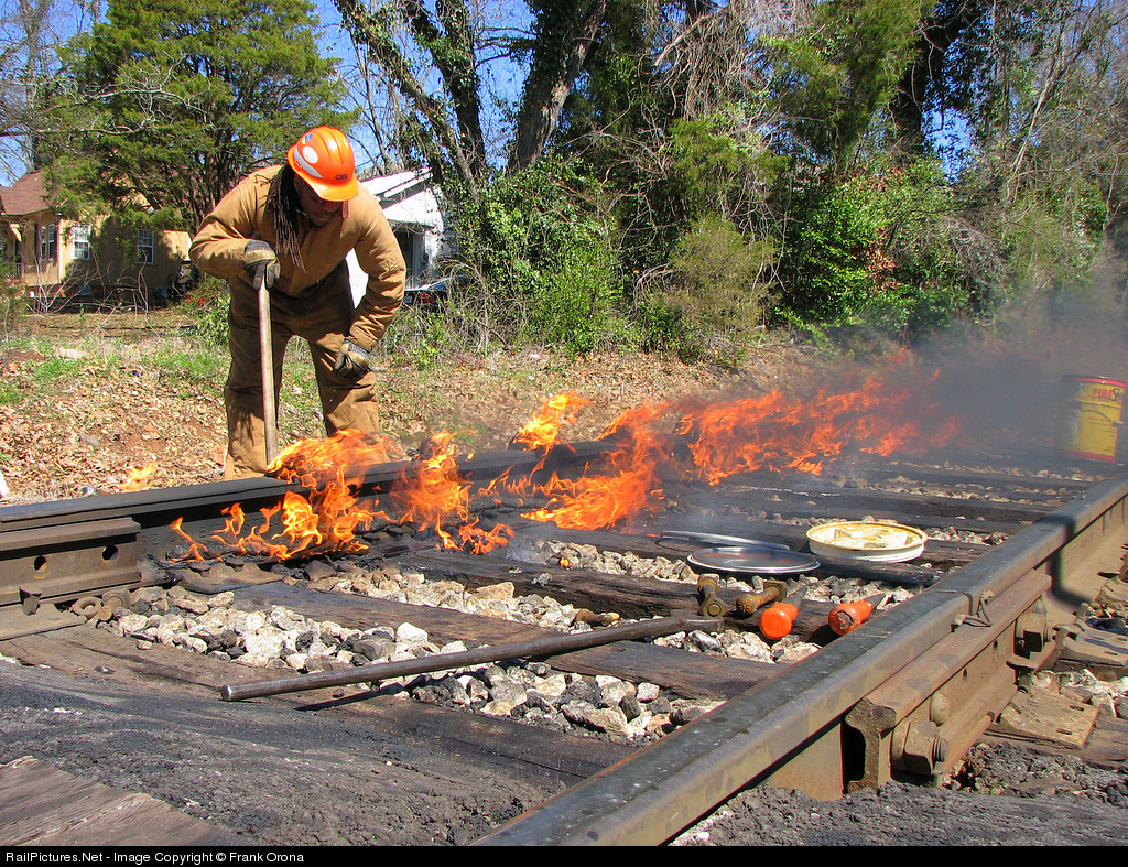

Fixing it, however, might not be as easy as just sticking the bolts back in. If the rails have contracted the holes may not line up. Oftimes the cure is to burn a kerosene soaked rope along the sides of the rail to expand it until the holes do line up.
I rather doubt that every roadmaster carries such a rope in his pocket–so he has to call for help.[:)]
“Harry - are you wearing cologne?”
He may not carry one in his pocket, however, if his hi-rail truck doesn’t have some, he has not properly stocked his hi-rail vehicle. All MofW truck should have such material on hand, especially during the Fall and early Winter when large temperature changes find all the weak rail joints.
