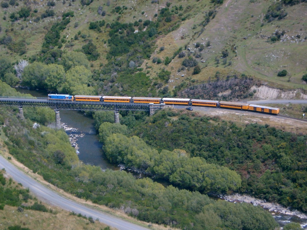

Here in New Zealand we had several road/rail bridges. This one was recently replaced after 120 years service;
http://www.flickr.com/photos/29564546@N07/2854658977/
http://en.wikipedia.org/wiki/File:Arahura_River_bridge.jpg
This is another road/rail bridge that was originally a rail only bridge but was recently modified for road traffic;
http://www.frankship.com/030Dj_Hindon.jpg
Bill
