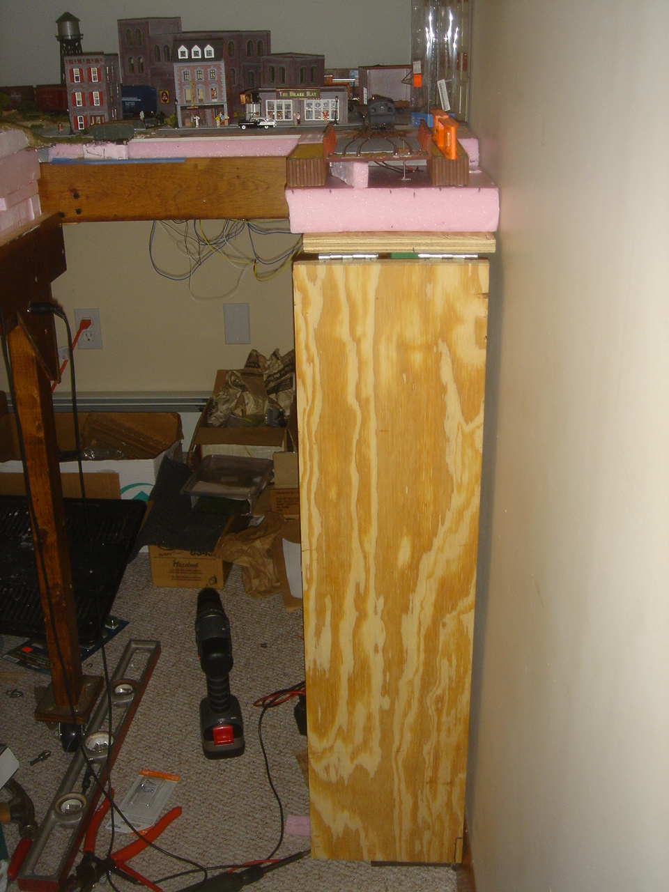

My casette system is a carfloat. I built one and have another kit on the to-be-done shelf. The apron protrudes a bit from the benchwork, and the base is supported on a folding shelf. It is hinged at the layout end. Here it is folded down.

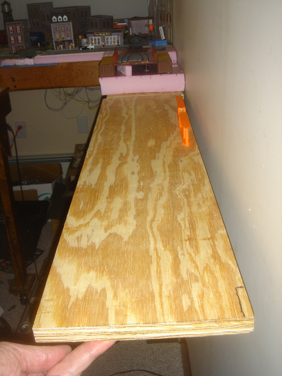

And here it’s lifted up. I didn’t have the leg installed yet, so I’m holding it up with one hand while taking the picture with the other.
The casette is the complete package of carfloat, foam base and masonite edging.

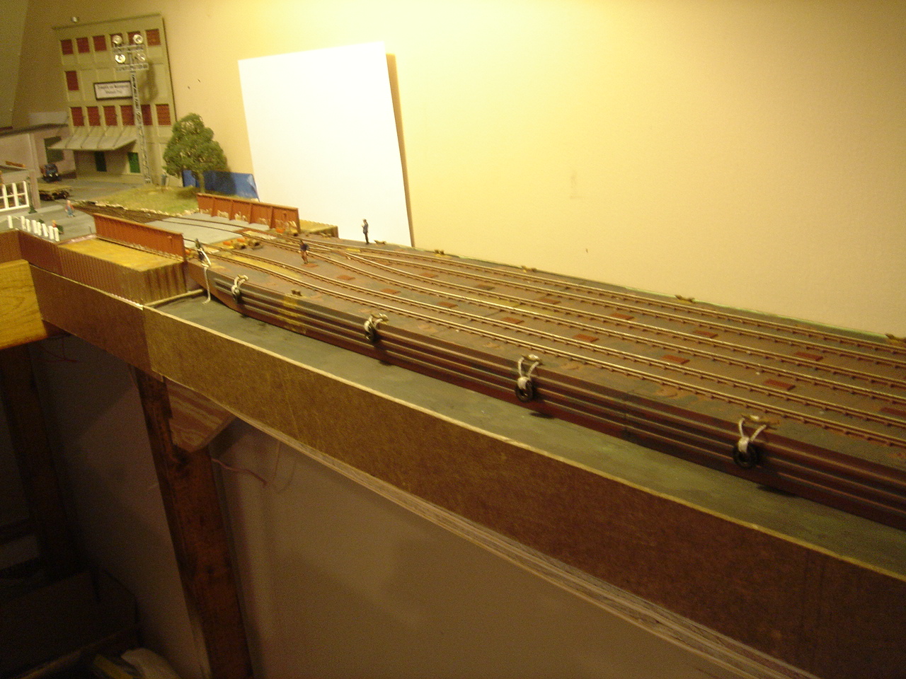

Finally, the base gets a lthin coating of tinted Envirotex and details are added to the carfloat.
