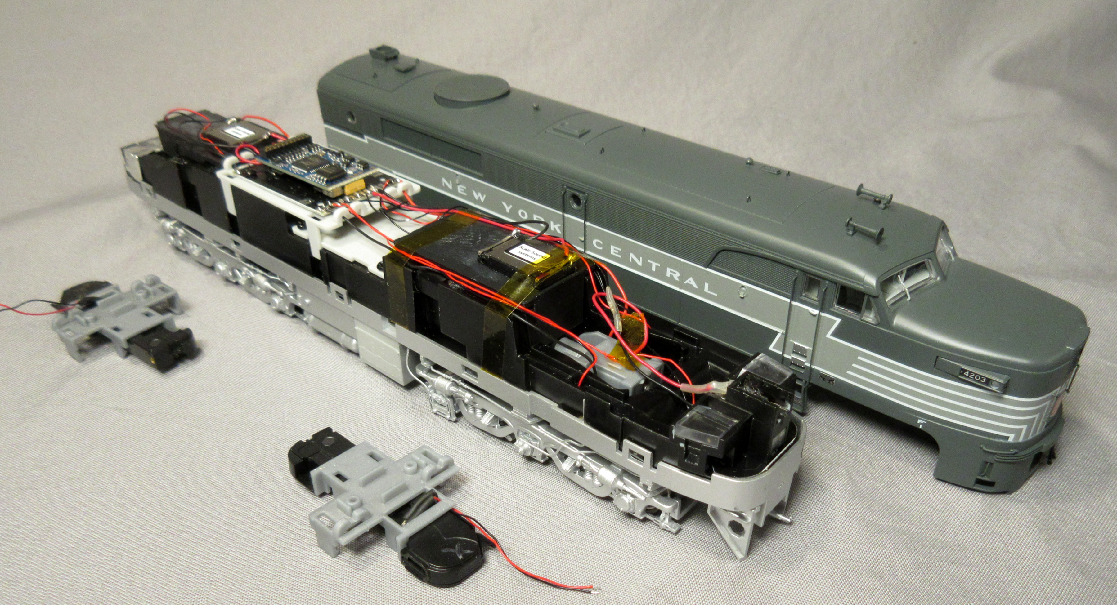

I’ve been using both cell phone and sugar cube speakers in almost all of my sound DCC installs. In most cases I like the sound from the sugar cube types a little better.
In this big Alco Century I used one of each:
Bowser_Century_DCC by Edmund, on Flickr
In most HO installations I can usually fit two speakers in along with the decoder.
