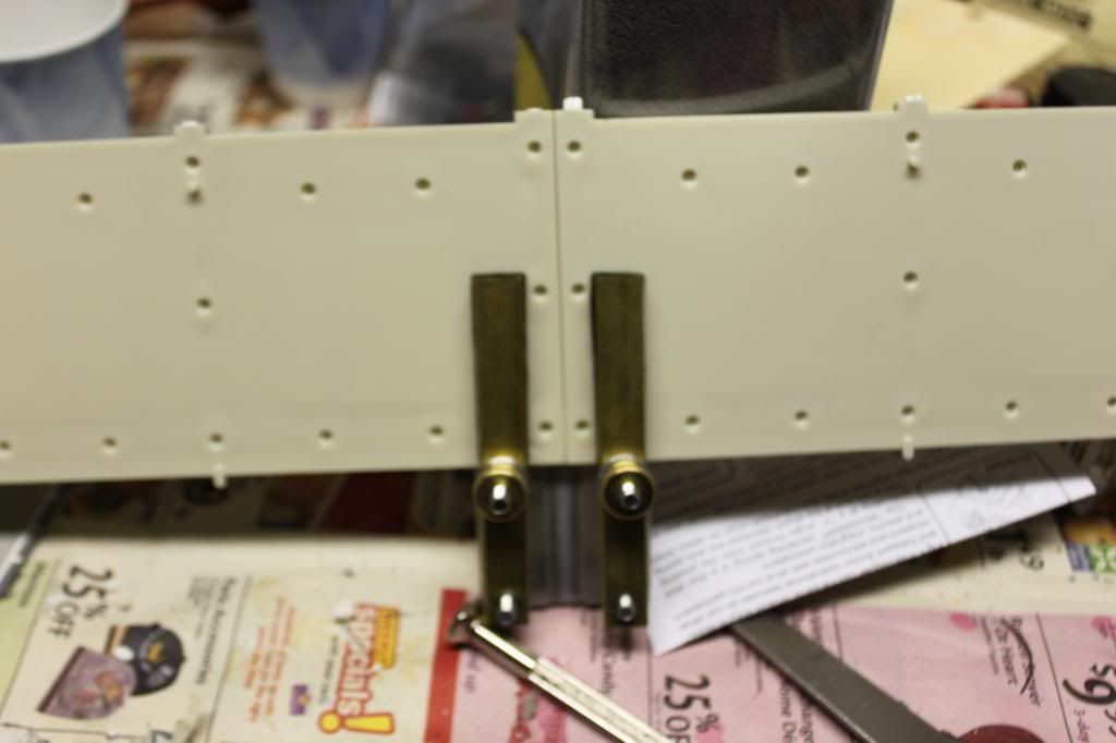

Another thing that can help you is a splice clamp. I just took this picture quickly to show. This isn’t a part being glued at the moment. It’s just to show you an example. If I where doing this for real I would put a piece of styrene behind the joint to make it stronger.
