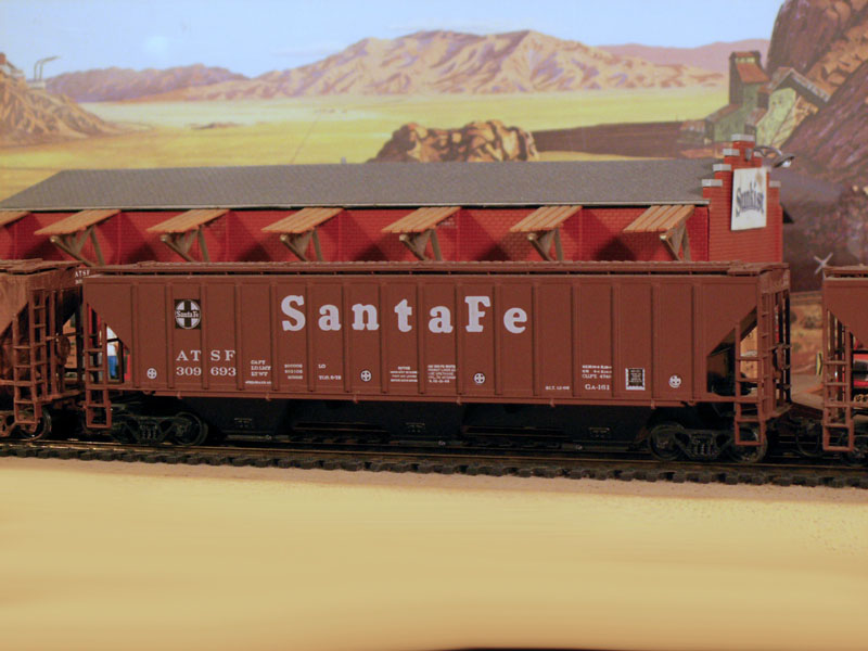

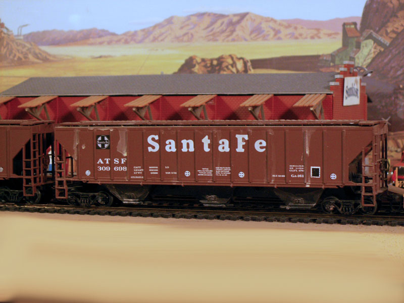

I’m pretty good at forging numbers on boxcars and other rolling stock, even diesel locomotives, but large numbers on the side of a tender are going to be harder. Depending on the font certain numbers can be altered by adding a tiny line of paint or scraping some away with a razor or exacto knife. A 6 can become a 0, etc. You only need to change one number.
