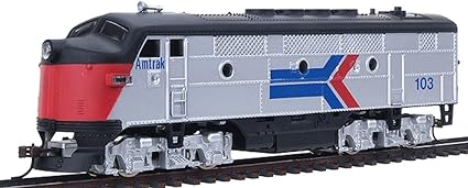

Apparently they did, though it doesn’t look that much like an F2A to me:
Looks like some mad combination of an FM C liner and an EMD F unit. Wow. Talk about not getting the nose contour even remotely close.
If that is the loco in question, fitting anything else under it will require some work, since it’s meant for a truck mounted coupler. Any potential replacement chassis, even Athearn, use body, or chassis, mounted couplers.
