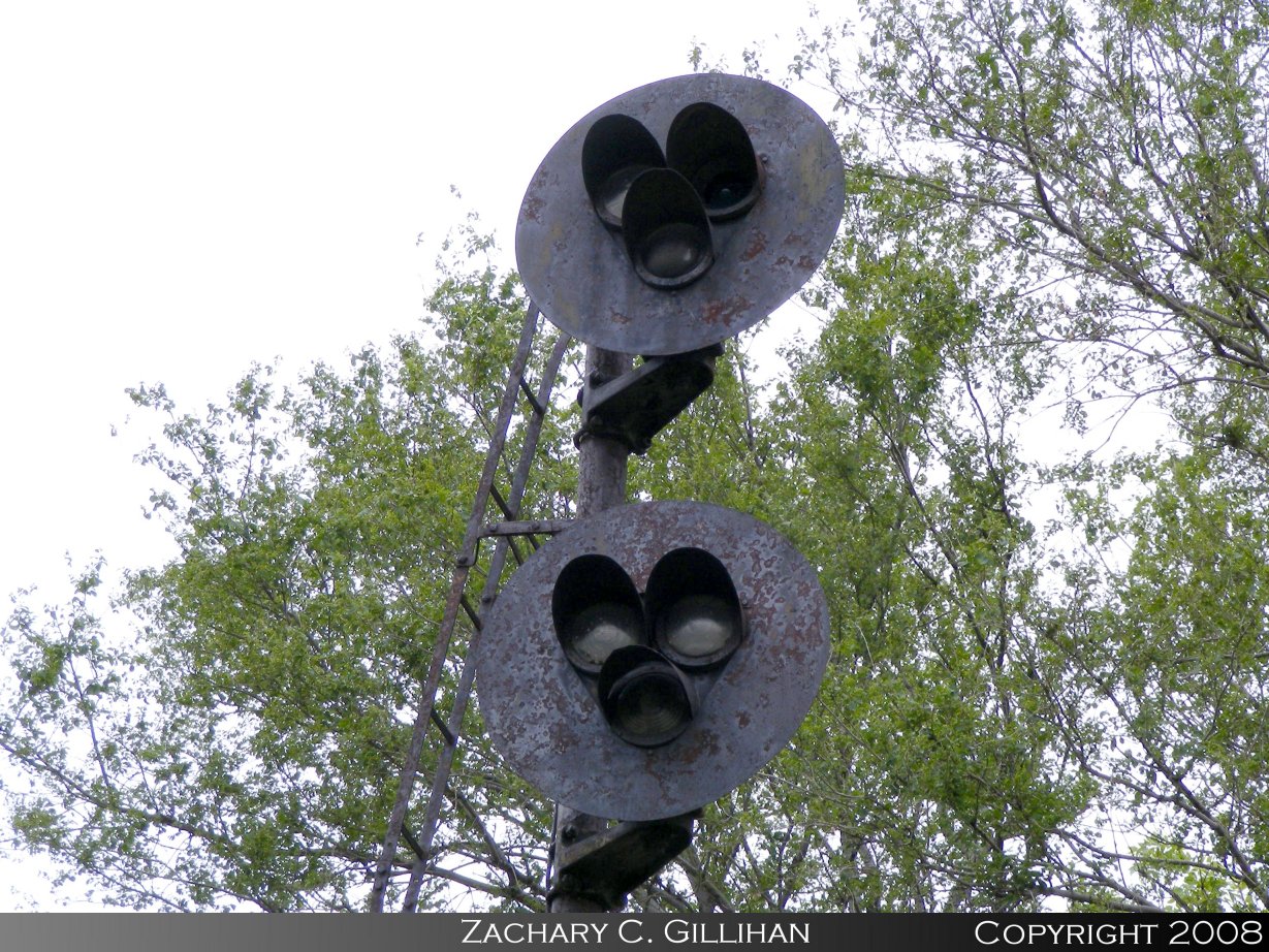

The signal type used is a Union Switch & Signal TR-2 type favored by the SP. Other users of this signal were the Rock Island and New York Central.
Signal picture
