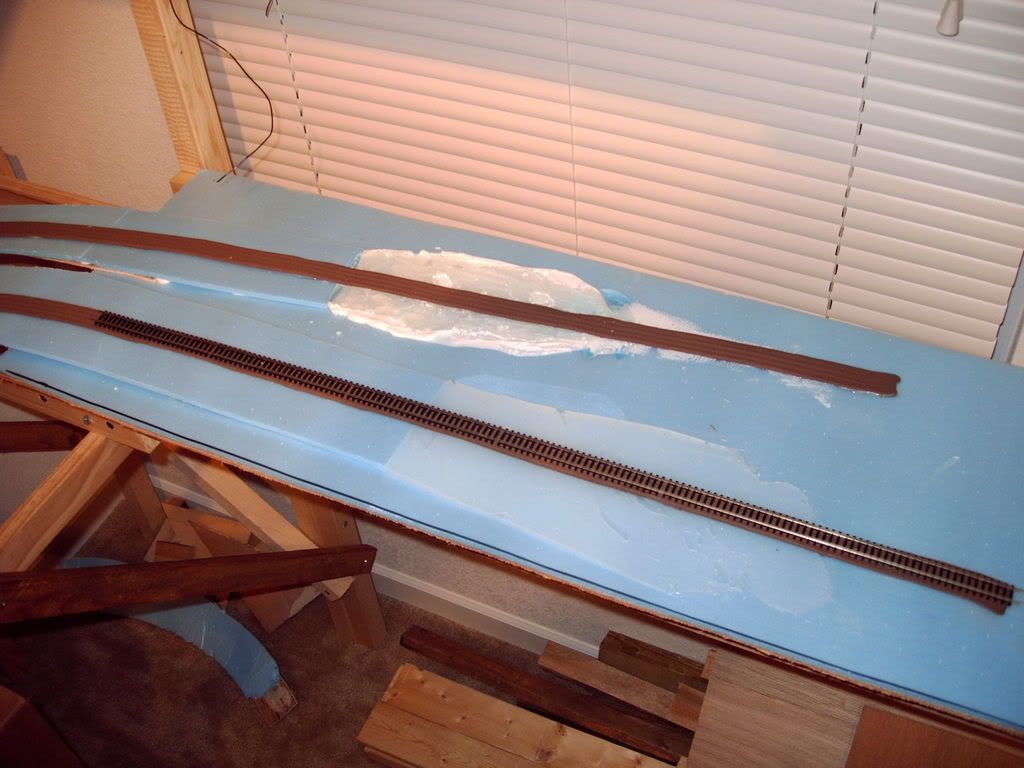

For those interested in a different, simpler, (and better, in my opinion) method of laying track, try the following method. I use Butyl Sealing Tape, which is used in sealing doors and windows in mobile homes and campers, and for sealing joints in steel buildings. This stuff is pretty resilient, it absorbs sound and vibration to a certain extent. This roll shown below is the second one I’ve use on the layout so far:
This wasn’t a new roll when I took the picture. Anyway, the first step is to lay out the track center lines using conventional methods.
Now, roll off a piece of the tape, in this case, to the end of the track.
Now, remove the wax paper backing strip, and lay the tape alongside your center line. Once it is properly positioned, press gently to adhere it. It’s reasonably forgiving, you can fairly easily pull it up for repositioning.
Now, repeat for the width of your track. This tape I used is about 3/8" wide, so I used 4 strips for HO scale. Use 2 for N

I’m familiar with the “topper tape”, but it’s only sticky on one side, the other side barely has any tackiness to it. Also, since it’s foam, it will have some “sponginess” to it, this stuff is more like Play-Doh (no, actually, more like the “poster hanging adhesive”, which is a bit more resilient), that will practically NEVER dry out. Remember, it’s designed for sealing EXTERIOR windows and doors, so even very long term exposure to weather and temperature extremes will not degrade the material for ages. I have noticed absolutely NO effects from heat, cold, humidity, water exposure, submersion, electrical shock, or even heat from a soldering iron (brief exposure).
This stuff is available in other widths and thicknesses, my local mobile home part dealer has the 3/4" and 1-1/2" available in about a 1/8" thickness. Like I said, mine was free, so I used what I had. If I had to buy it, I would have gotten the 1-1/2" stuff.
I’ve removed doors and windows from 40-50+ year old mobile homes, and, although the edges of the tape show some deterioration (outer 1/16" or so), the rest is just like the day the home was built.

Well, I went looking for the stuff you describe, thinking that I’d give it a shot. Couldn’t find it though. But I did find this, which is similar. I’ll just give links so I don’t kill the dialup guys. The pics are pretty good sized. Also, all of the product on the layout has been secured with a thin layer of clear latex caulk, so this is actually ready for rail to be laid. It’s kind of sticky out of the package, but I feel better with it stuck down good, ya know?
http://i83.photobucket.com/albums/j319/pcarrell/Autumns%20Ridge/Picture016.jpg
It comes in a roll like this. The tool is a wall papering tool available at the same home depot. It’s handy for making sure everything is level and for making ramps (more on that later).
http://i83.photobucket.com/albums/j319/pcarrell/Autumns%20Ridge/Picture019.jpg
Like I said, it’s kind of putty-like, so it can conform to curves.
http://i83.photobucket.com/albums/j319/pcarrell/Autumns%20Ridge/Picture023.jpg
And it’s wide, so I cut it in half lengthwise and it works pretty well. With ballast it should look great! (I just set an old piece of Atlas code 80 on there for the shot)
http://i83.photobucket.com/albums/j319/pcarrell/Autumns%20Ridge/Picture021.jpg
http://i83.photobucket.com/albums/j319/pcarrell/Autumns%20Ridge/Picture003-1.jpg
And about those curves…the tighter curve is the tightest on my layout. It’s a 17 1/4" curve. Look how nice it lay
