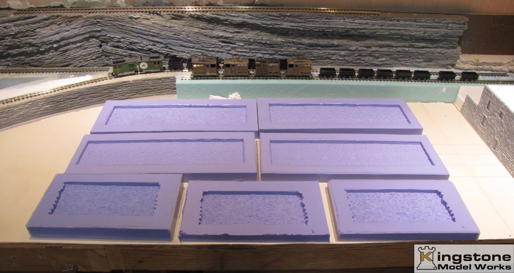

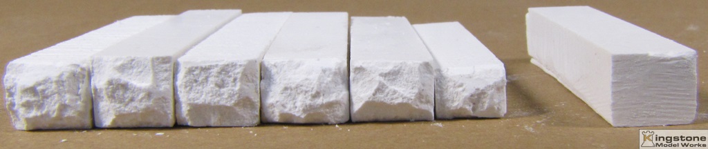

If you don’t mind a little bit of extra work you could always cast your own walls using the “Chooch Flexible Walls” as masters. I was actually looking to use the individual stone cut from the cast wall to make my own building walls before I figured out how to get that nice fracture rock facing look these vinyl walls have.
I actually did seven molds, two of the medium cut stone, two of the small cut stone and three of the Random Interconnecting Wall #8302 HO/O scale.
walls
I experimented with two different casting mediums, Durham’s Water Putty and Hydrocal.
The top two castings I used the water putty. The bottom one I used Hydrocal.

There are literally hundreds of molds available. Maybe 10 are suitable for model railroading.
My friend Chris uses dental plaster in his Hirst molds, I use Hydrocal with fine results. I only have the two molds that I pictured in my post. Chris probably has 50 or more.

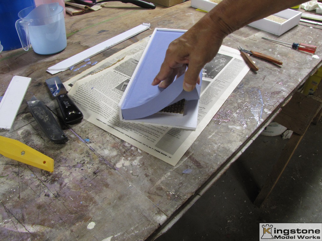

The cast walls are not flexible since they are cast Hydrocal or water putty. I don’t think they would bend to much while still a little bit from full cure. The only thing I think one could do is bend the mold, but you’d have be careful if you bend the mold to far that the casting material wouldn’t leak out.

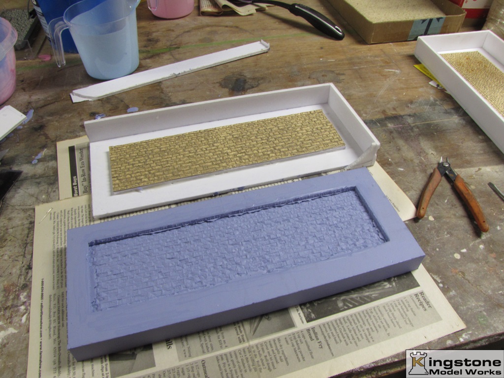

Here’s the ultimate goal of casting my own walls. http://southrivermodelworks.com/page160.html
What I wanted was for the stones/blocks to look like this.
Bernd

Make the ‘casting’ as a thin film, e.g. by brushing a flexible material, perhaps some form of RTV, over the mold using an appropriate release agent, and cure under vacuum if bubbles are an issue. Then curve the result as desired and back it with cast plaster or dental stone to make the final curved panels.
