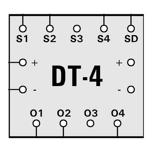

I think this might be what you are searching for:
Thanks, that clears that up.
That is for an earlier version of the device (see the reference to AN-5615).
It may be possible that the internal switches in the ‘older’ switch motors work the same as those in the 6200 series, and reading the corresponding Application Notes (particularly as provided for the 6000 series) might get him to enough information to figure out an approach.
Not sure what the differences are between the Smail versions. But it appears to me that actual work is done by the TC 3 and 4 devices.
If that’s so, and I see little reason why it wouldn’t be so, then the Circuitron AN-6000-10 which explicitly says it covers ‘non-derailing’ operation under DCC ought to be ‘the nuts’ for him.
Unfortunately when I select this from their support page (see above) I get a note that the file is unavailable. The choices before and after it in the list download correctly, so this is not a site failure. It does indicate that someone… perhaps a few someones here… should e-mail Circuitron with the specific request that this AN be restored (and, of course, upgraded to AN-6200-02 or whatever the cited note in his instructions was given as)…
