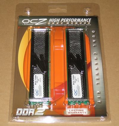

You won’t find many N scalers over in this forum as most of us are working in scales 10 times that size. You can use the the flat portions of clear plastic packaging (the kind that is a pain in the [censored] to open) though it might be a bit thick for your purposes.

I get window glazing free with each purchase of an Atlas turnout. I use the packaging - it works like a charm.

I use the clear stiff packaging that seems to come on everything from Wal-Mart these days. Once it’s in the structure, most people can’t tell the difference even close up.
