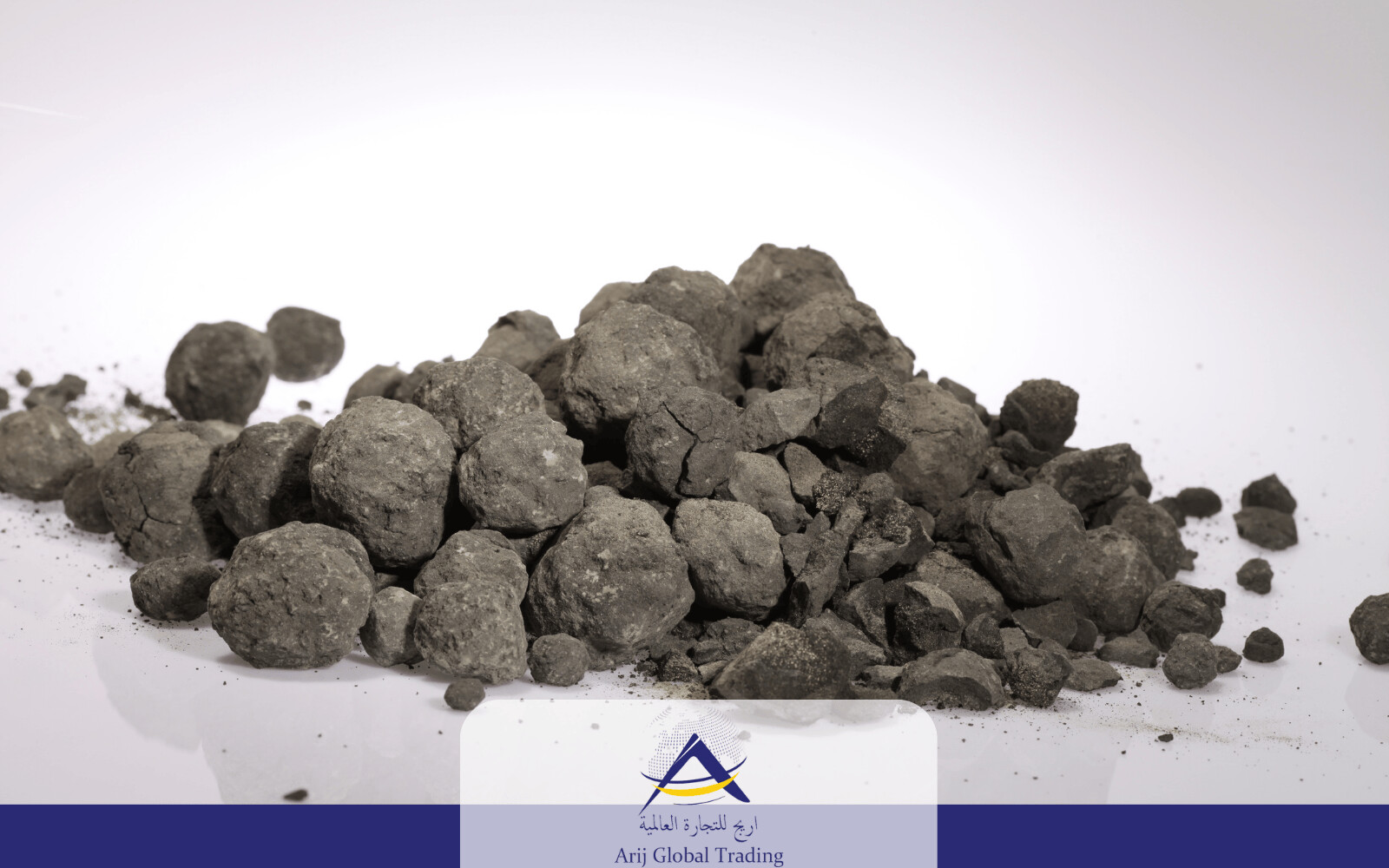

I was curious so I looked up the meaning of “clinker”.
Seems that “clinkers” are a manufactured product used in the making of cement. Fly ash is used as a replacement for clinker.
See:
https://arijco.com/articles/what-is-clinker/

Maxman, just wanted to confirm that this was more of what I was referring to. From my understanding it is the material that would be shipped to the cement industry I am hoping to add, have gypsum added into it, and then eventually through some process ends up as Portland Cement.

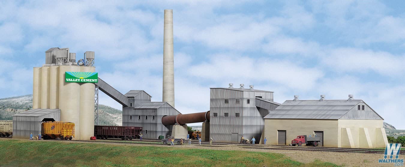

And Walthers made a cement plant kit that included that rotating drum thing:
