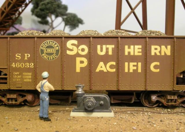

Glad to see other modelers using Tyco operating hoppers. I have 10 Tyco hoppers that I have modified with sprung trucks and body mounted couplers. Tyco hoppers are a near prototype for Southern Pacific ballast cars. This is how I modified my cars. http://lariverrailroads.com/gravel_pit.html
Very nice “How to” on your site thanks for sharing
