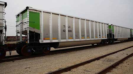

Here’s an image of such cars with the end panel marked as noted.
Rotary Dump Gondola
Generally speaking, you’ll find these cars in unit trains. While it’s possible that the cars will be uncoupled and dumped individually, for best efficiency, they’ll stay coupled and be dumped, one or possibly two at a time, while coupled in the train.
Thus it’s important that the dump operator knows he/she has rotary couplers in the appropriate positions.
If you see such a train, you’ll usually see all of the marked panels facing the same way on all of the cars…
