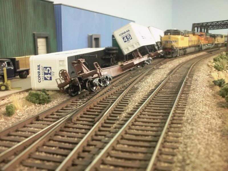

Check out the pic of a #8 on my layout below. Please excuse the derailment due to operator error [(-D]

Thanks, that looks great, I think I am going to go with the Peco switches! When you weathered the track did you cover anything up, or paint the entire rail, ties, etc…
