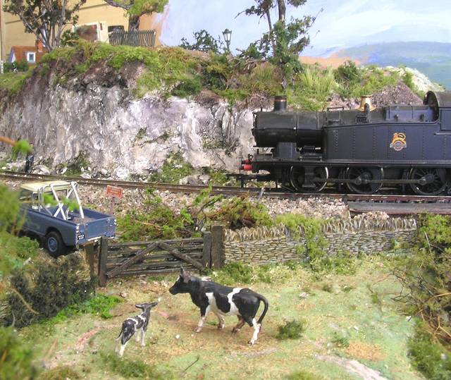

If you’re not modelling a specific location I’d suggest you experiment somewhere with loads of different colours e.g. black, brown, green, blue, red and even purple. Wash the colours on thinly, starting with a thin wash of say black mixed with brown and let it run into the crevices. Wet the rocks before dribbling it on. Keep your paints thin and therefore transparent. Use the whitness of the sculptamold to lighten them by keeping them transparent and thin.
The fact is depending on the type of rock you can get away with pretty much any colour if you use the paint thinly. It’s when paint is caked on that you can get problems. In my English chalk cutting I used black, blue, purple and green, with a few whiter highlights added as a final touch. There’s a bit of yellow thrown in there too I think.
Maybe this pic of the rock cutting on my US layout will show what I mean.
You can always rub chalks over the surface when the paint is dry. They help kill any sheen too.
Hoping this helps.
Mike
