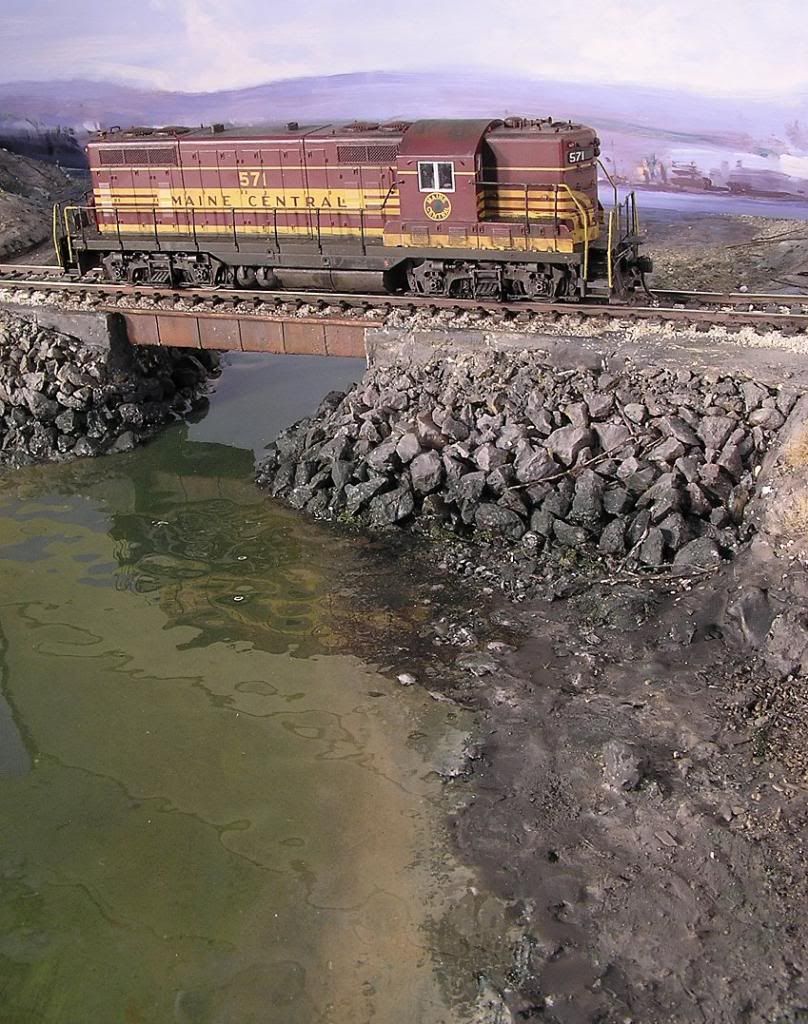

This is an earlier picture showing the pre-Envirotex look of the canal I’ve been working on:
With a few layers of tinted Envirotex, the bottom becomes murky.
The key is to use just a bit of paint. For this project, I used an ounce or two of Envirotex for each pour. To that, I added a drop of paint, perhaps an eighth of an inch across.

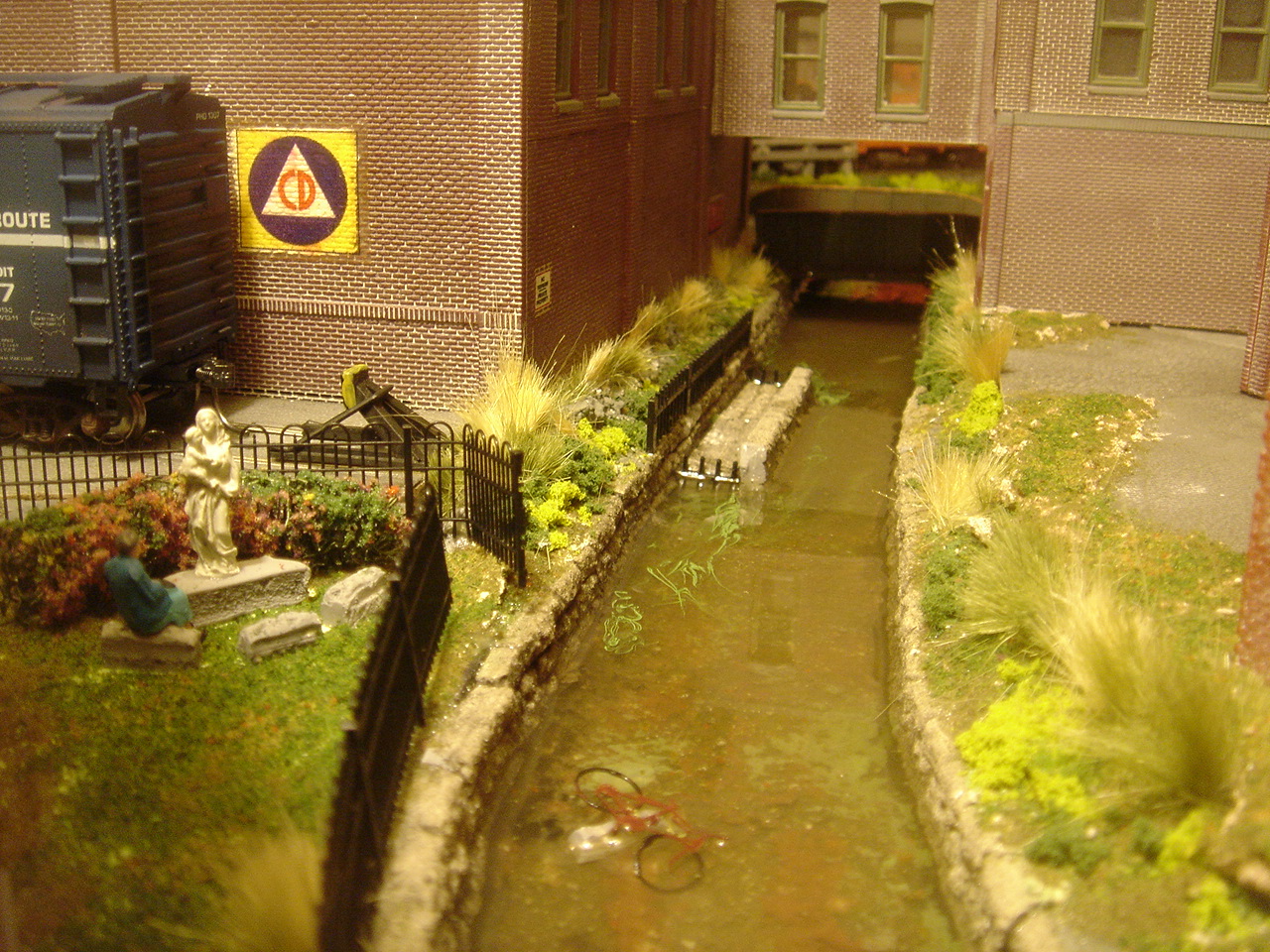

Like Mr B, I use Envirotex and craft paint. For my small swampy pond, I used a drop maybe two of olive in the first pour, one in the second, very little in the third, none in the final two.
