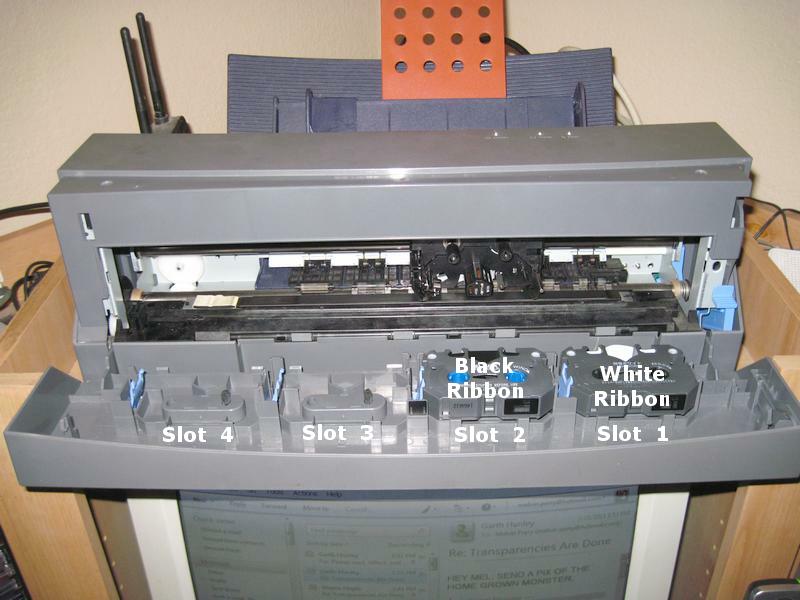

The early Alps printers would print white. I have an Alps MD1000 and it does a bang up job printing white on decal paper. The ink is actually on a ribbon similar to the old IBM selectric typewriters. They also make silver & gold ribbons.
There are a couple of problems with the older Alps Printers as Alps no longer provides support. The newest driver is for Windows XP and the printers require a parallel printer port.

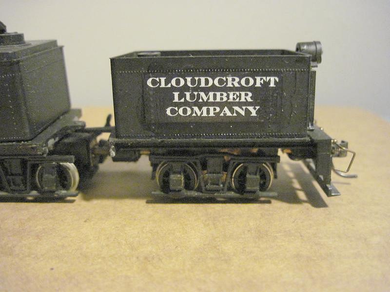

Decal printed on my Alps.
Gold ribbon.
Silver ribbon.
If you buy an older Alps make sure the print head is working perfect and tell the shipper to remove all ink ribb
