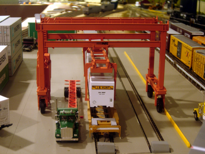

Here’s an intermodal terminal I built with all styrene to simulate concrete.
