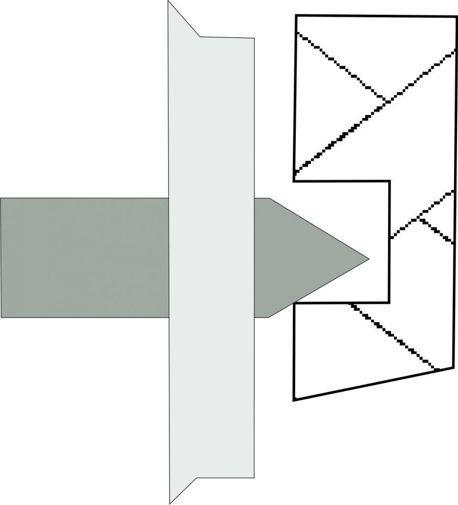

I would think the conical axle end would wobble in the cylindrical hole and not perform at all? See my diagram below.

The answer is “No”. I have a brass tender that had the same problem, and I had to order a non-cylindrical wheel set from NorthWest Short Line as a replacement. Check their website, they offer both tapered and ‘shouldered’ (the type you’ll need) wheelsets in just about every gauge and size imaginable. If yours is an HO scale bobber, I’d think 33" shouldered would do the trick.
