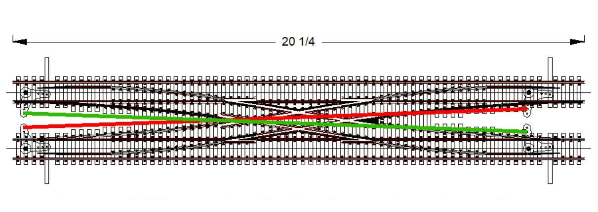

In my original planning I had been going to utilize a couple of double crossovers by Shinohara that I had picked up at a train show a number of years ago. As I got to studying them, and discussing them here on the forum, plus running some experiments with them, I began to look for alternatives.
Turns out I had room (length enough) to utilize 2 pairs of single crossovers rather than the doubles. I also discovered that I could make very effective single crossovers using 2 Peco large size turnouts back-to-back. Here is a comparison,…Shino Dbl on left, then Peco large pair, Peco med pair, Peco sm pair,…
I ran experiments with those Peco large pairs and was very satisfied.
So where I was going to have a dbl-crossover, I will now have 2 single crossovers consisting of 4 large size Peco turnouts.

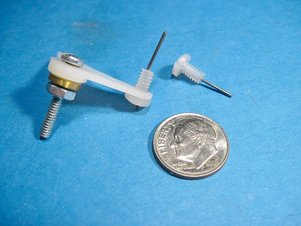

I don’t have any pictures of my bellcranks (Du-Bro 167) but I’ve used them for years for doing weird things. For my turnout control I drilled and tapped the outside hole of the 167s in one arm for 4-40 thread.
I used a 4-40 Nylon screw in the bellcrank as a holder (support) for .02” steel rod for the throw arm to the turnout which works great for Atlas turnouts, you might have to go with .03” rod to overcome the Peco spring. I start out with a 1” long 4-40 Nylon screw and shorten it as needed. For long steel rod throw the longer the screw to give it the strength need to move the turnout points.
I drill a hole through the Nylon screw length wise and insert the rod. The hole in the Nylon doesn’t actually keep the drill size and shrinks a bit when the drill is removed making the rod a tight enough fit that it doesn’t need glue and is easily adjusted if needed. I do glue the screw in the bellcrank to prevent it from loosing up.
Drilling the small screws length wise sounds like a tough job but in all the screws I’ve drilled (dozens) I can only remember screwing up a couple of screws. I made a holder in a 3” square double layer .08” piece Styrene and drilled an tapped a 4-40 hole in the center. I set my bench drill press at 480 RPM and do it to it very slowly.
For multiple turnouts I use the middle hole on the driving bellcrank to the outside hole on the driven bellcrank with .040” steel rod between them.
