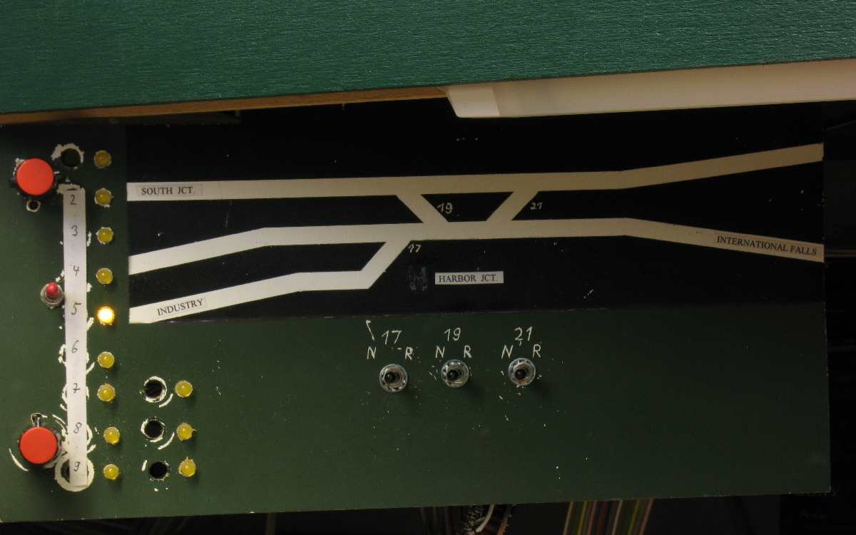

I have a DCC layout but I like to operate manually thrown turnouts like the prototype, manually.
So my contorl panel has a few tortoise driven turnouts, controlled from the yardmaster.
Or at Harbor Jct where you have control over staging entrance.
Wolfgang

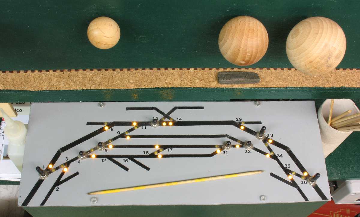

I have an 11’ x 12’ layout with 2 control panels. Here’s a link which shows how I build mine. Here’s a picture of one control panel.
