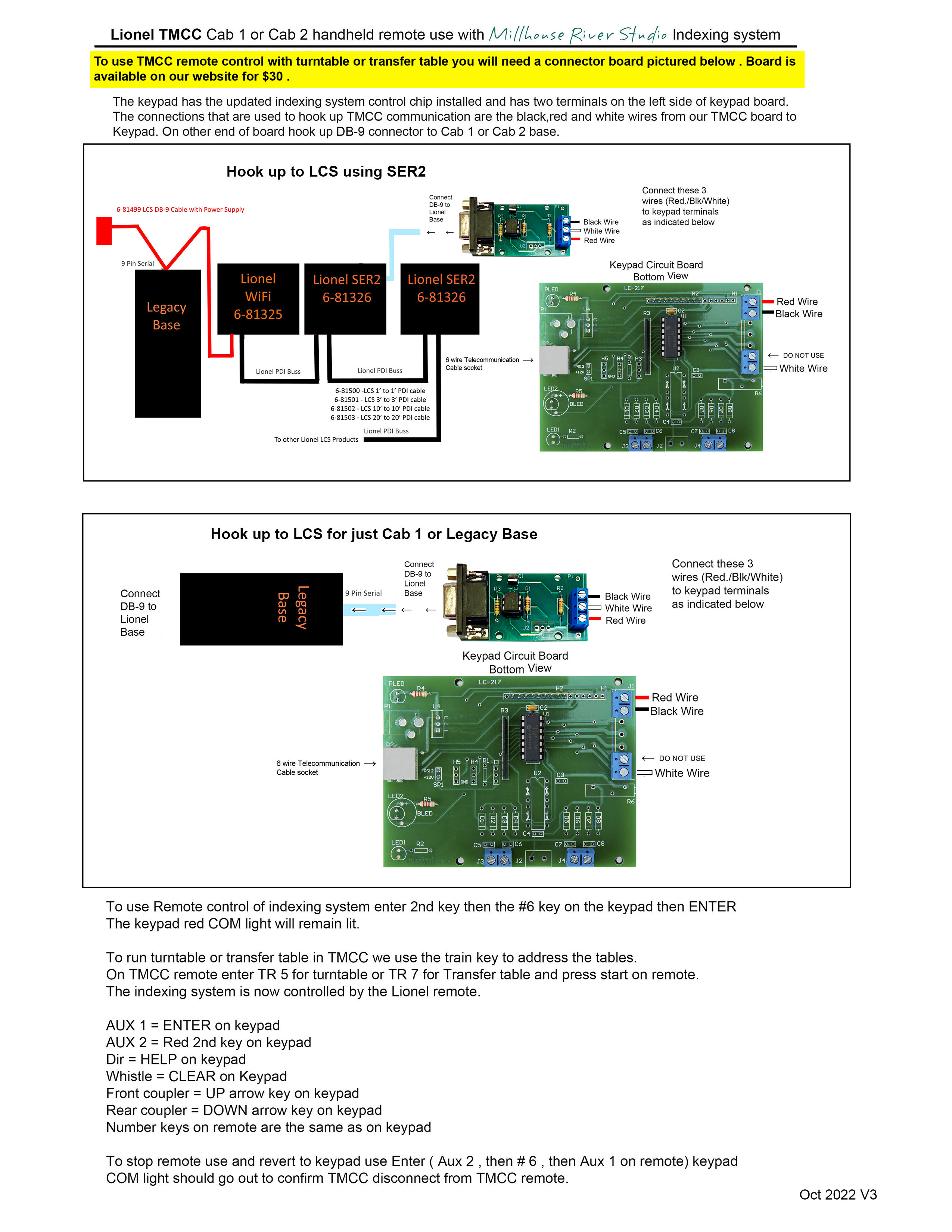

I purchased a Millhouse River Studio turntable in an auction of a layout that was being dismantled. Unfortunately, I did not get the indexing controller with the turntable. Millhouse charges $562 for their indexer which is outside my budget. I would like to know if any other turntable controllers will work with the Millhouse unit, e.g. the Walthers Cornerstone controller that sells for $50.

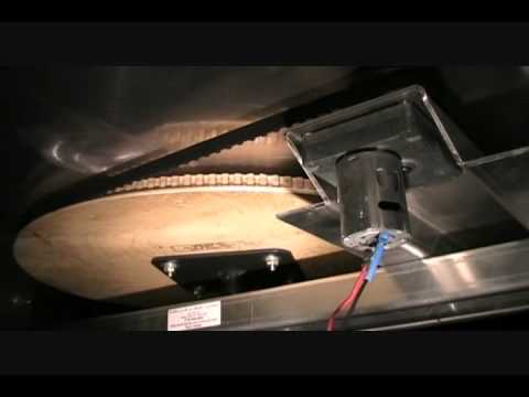

Just as a note:
At 6:15 they note explicitly that their belt drive makes an indexer unnecessary.

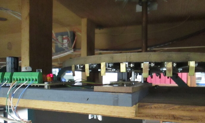

an older approach uses a slot detector and tags attached to the plate under the turtable to detect each track. the tag can be nudged for precise alignment
you would need to develop the software using such an approach
