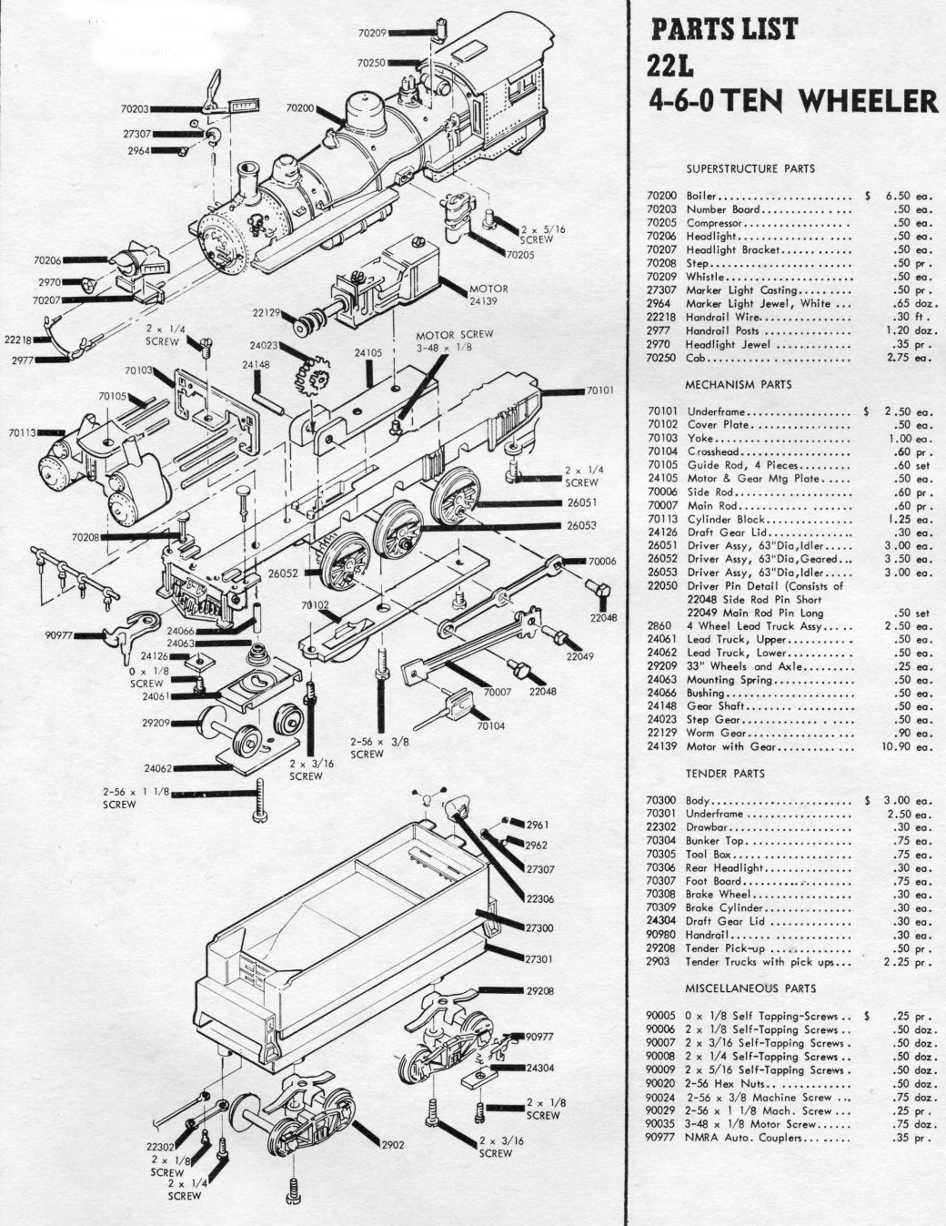

The below looks like what you have.
http://www.hoseeker.net/assemblyexplosionMdc/Assembly%20Explosion%2022L%204-6-0%20Ten%20Wheeler.jpg

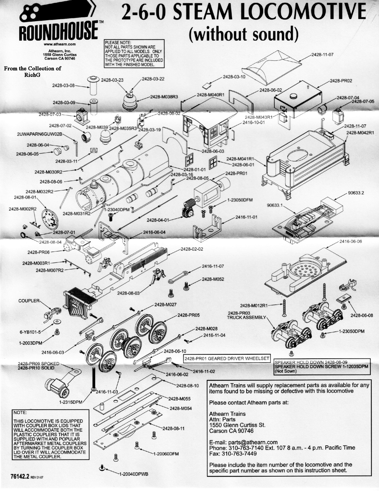

The newer Athearn Roundhouse are the below arraignment.
http://www.hoseeker.net/assemblyexplosionMdc/roundhouse260diagram.jpg
