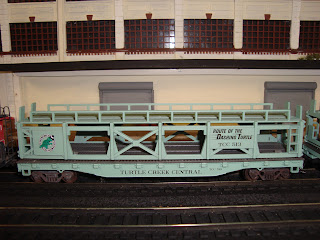

I went and check some of the cars I have done in the past and found that some took 36" wheels and under set couplers like #37 to achieve the right heights and good rolling characteristics. The car below was a bright yellow and red ATSF car carrier that I stripped painted and added couplers and wheels. This car needed the under set shank couplers and the 36" wheels.
A Turtle Creek car carrier. First one I’ve ever seen. I gotta do something with the set of decals I have for the Turtle Creek. [Y]
Nice looking car!
