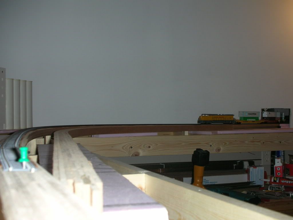

I will not tell you what to do or not, just tell you what I did.
I had some problems to get the top if my masonite splines even. I talked to Lee Nicholas, one of the guys that ‘invented’ spline roadbed. He had similar problems but they went away when using cork on top of the splines. For me it did a lot more then even out the spline roadbed. I got the 45 degree angle for the ballast and the track is very quiet. Look at this picture and compare the splines with and without the cork. I’m very satisfied and will continue using cork on top of the splines.
