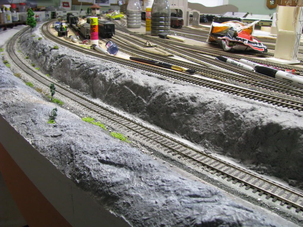

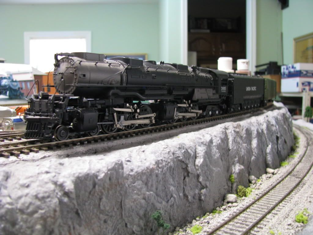

I use plaster cloth or plaster paper towels first and then Scuptamold for the final coat with shaping/modeling the rock faces. Here is a couple of areas done tis way. I seal the entidre area with gray latex paint and then use washes. Works for me.
-Bob

I don’t have any photos of the actual detailling process but I will say this; using a rubber kitchen spatula ($1 at dollar tree) and a few small dental and clay tools, you can do wonders with Sculptamold. I first pack large spatula full globs onto the hard plaster cloth base and using a few spreading moves you can almost see ‘natural’ rock shapes appear in front of you. This is the time to work the larger masses to the general shape you want. After it has set for about 10 minutes I use the smaller detailing tools to make more defined crevises and will try to make a series of them to form a ’ fault line’ so to speak;; when you step back and look at it you will see a ‘connection’ between several of the larger rock masses. I use photos of actual rock formations and other modelers work on the internet. Just be sure to smooth out any bubbles or ‘stringy’ areas that look like Sculptamold (the fibers that is, duh?). I would practice on an area on your layout and when you are finished and painted with it, you will see areas that you might not like. Just put some more Scuptamold on it and make it better; you will be amazed at how easy this is once you get the hang of it. I originally planned to do it like I always did before; wire window screen with Hydrocal/plaster. Scuptamold has a long working time so you can keep making changes to it. Just jump in and give it a try, it is actually a fun part of scenery.
Good luck,
-Bob
