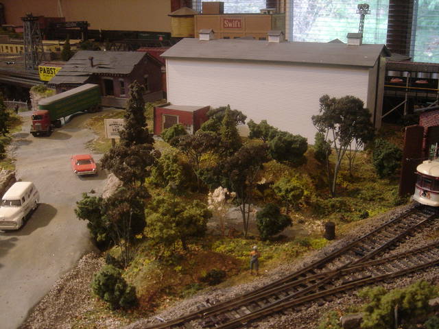

They are big, and the model is very white. I toned it down a bit with a very light wash and some Dull Coat. I put a lot of greenery in the foreground, too, which distracts from the building a bit.

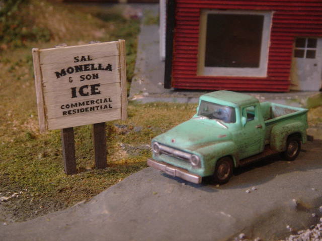

I added a small “office” building at the lower left corner. This lets a small commercial ice operation operate out of the larger facility.

Very nice modeling! I like the idea of an office (I now may add one). I toned down the large plain back wall with a large sign that says Western Pacific Fruit, Ice, Storage. Also, Ice House No. 1. Then a couple of railroad Heralds on each side. I also like that streetcar or trolley at the corner of your picture.
