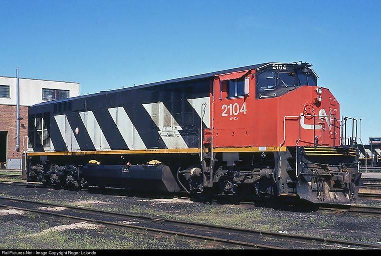

Could this be considered the last Alco ever constructed?
2104 one of a tiny order for only 20 units from Bombardier believed a compelled purchase to keep BBD in business. Nobody else ordered any! Soon, Bombardier closed the former MLW plant ending Alco production in North America.
Canadian National Railways
BBD HR616C
3000 HP full width carbody with Draper taper.
2100-2119 (20) Only order from any railway.
Note: 2117-2119 built with Hitachi traction motors.
2119 built with LRC style controls.
2100-2103 built 2/26, 2/26, 3/26, 3/26/1982
Retired 2/11/1983 sold back to Bombardier, Inc.
Units shopped, modified 3200 HP M6118-01 to -04 3/1983
and sent out as demonstrators 7001-7004 on CP Rail
Repurchased by CN 5/25/1984.

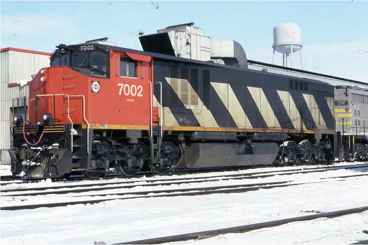

BDR 7002 ex CN 2101. CP Rail Toronto Yard. March 4, 1984 Bill Grandin
Note: QNS&L 214 behind.
