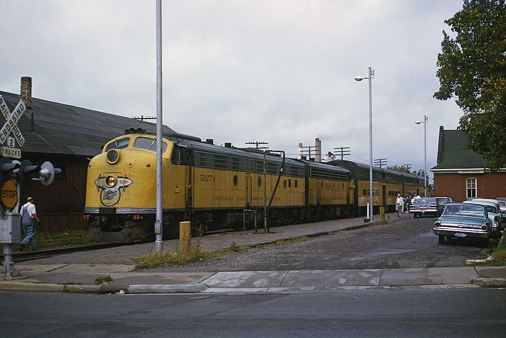

Reminder that the C&NW did have true bi-level long-distance coaches. And they were used by Amtrak

On C&NW those bi-levels were fairly short distance day trains (coaches only). The Flambeau 400, Chicago to Ashland, WI was the longest, 452 miles. The dining car on the Flambeau was single level with a false roof to match bi-levels coaches.

In part the bi-levels were the result of WisDOT pushing C&NW to do better with passenger service.

Wisconsin agreed to cutting off some money-losing NorthWestern services (keeping Milwaukee Road competing ones) in exchange for upgrades on the more lucrative routes like Chicago-Milwaukee-Green Bay.

These were just commuter cars with longer distance seating (coach, parlor, lounge style). They’d be just about impossible to be satisfactorily useful for today’s travelers with wheelchairs, luggage, bikes, strollers, etc. Even Metra is abandoning the gallery cars after feedback from users. The on order Alstom Coradia cars will be true bilevels like in Europe, Long Island, NJT, LA Metrolink, Caltrain.
