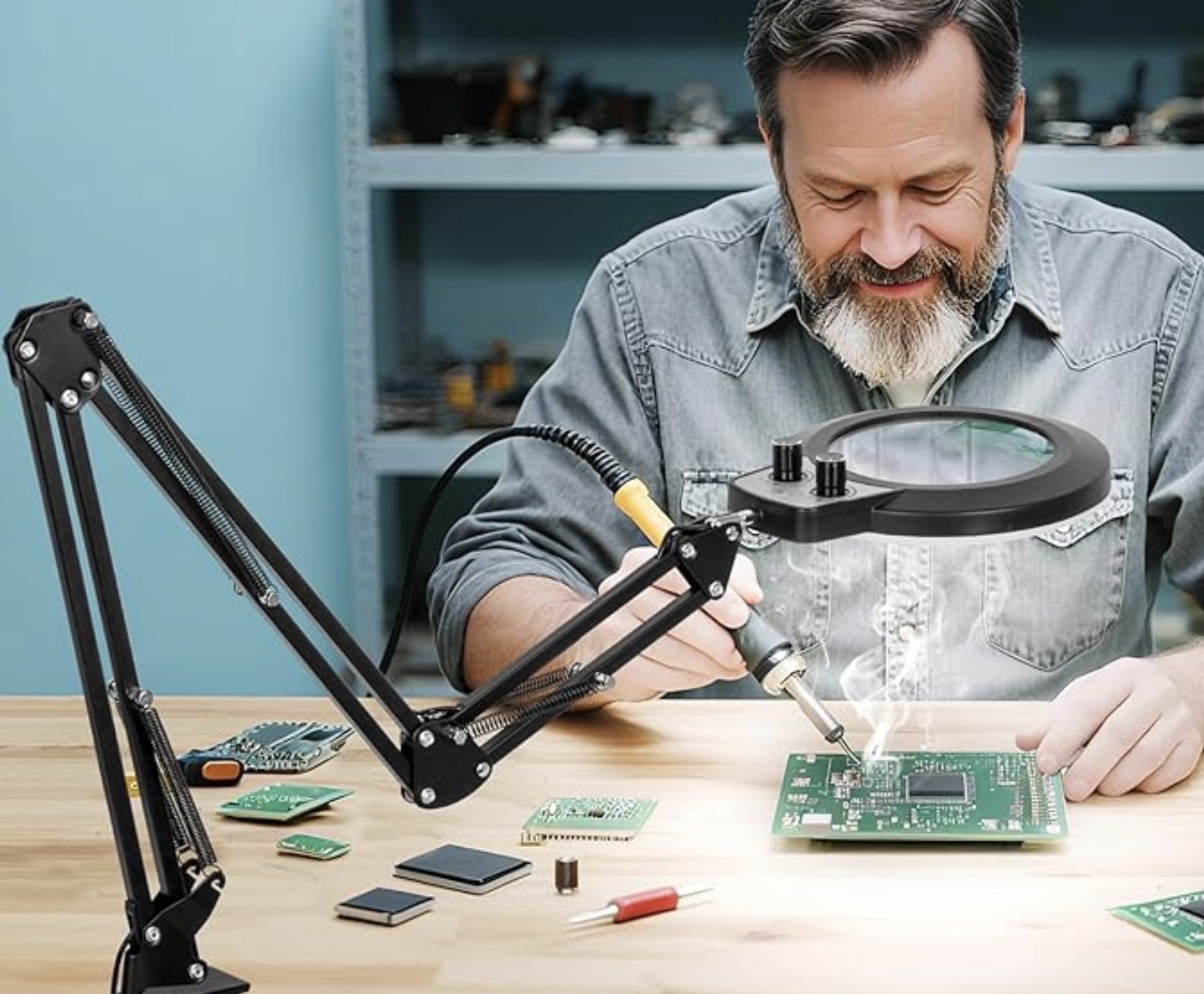

Also… finally ordered one of these… (workbench mounted magnifier)
those darn knuckle coupler springs are awfully tiny to work with!
To make the knuckle springs slightly easier to install put a tiny dab of almost any kind of glue (I use white glue) on the pin closest to the coupler shank. Place the spring on this one pin and let the glue dry. Then when you go back to get the spring onto the pin on the movable knuckle the spring can’t launch itself toward the moon.
