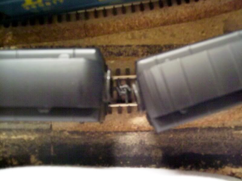

This is how far misaligned the cars are going into a 26" curve. I’m seriously re-thinking the diaphragm and body mount coupler thing.
