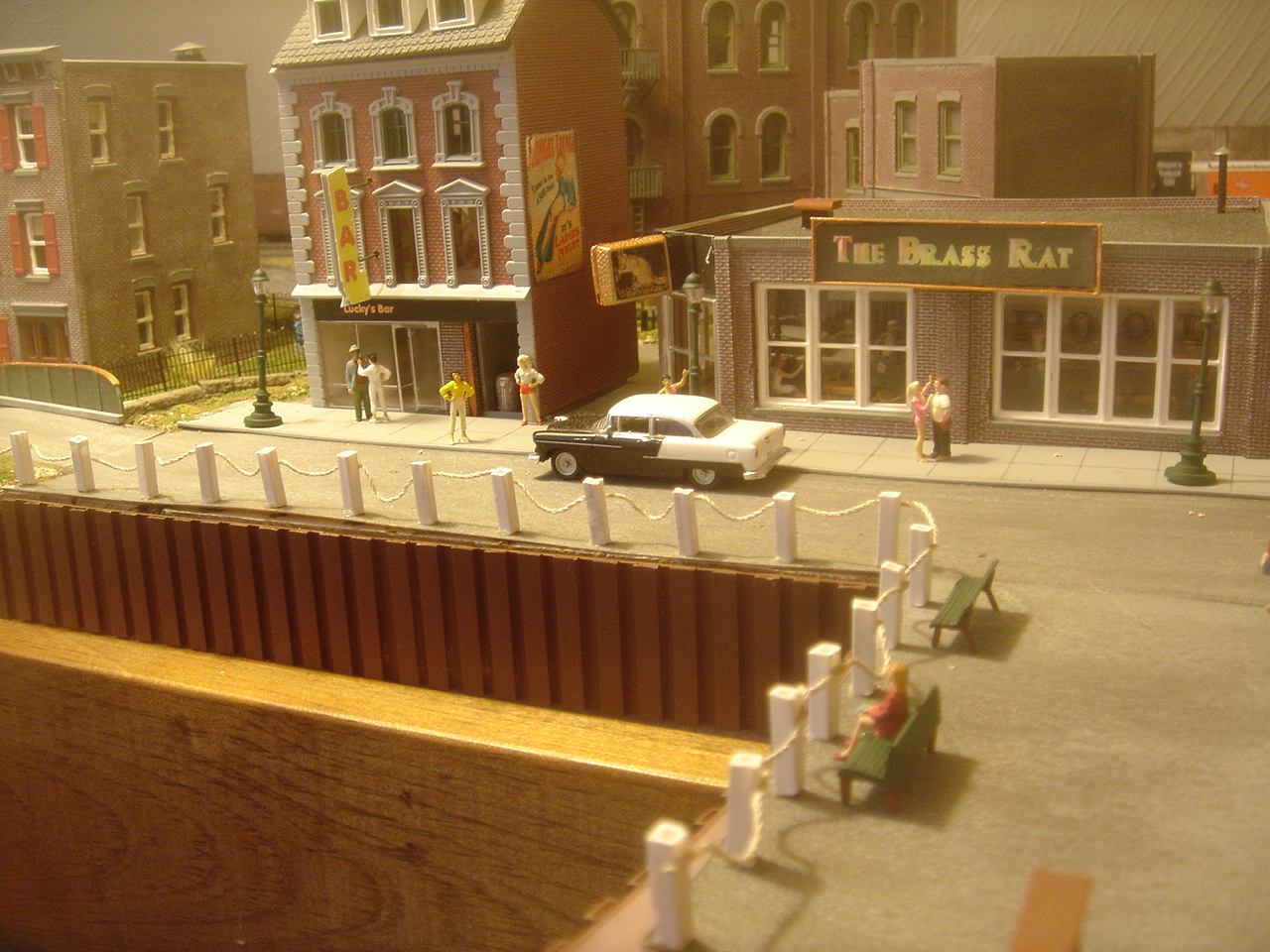

Here’s how I replaced fascia with a bulkhead on my layout. The carfloat apron is around to the right, and this scratchbuilt bulkhead matches the side walls of the apron, giving some continuity to the scene.

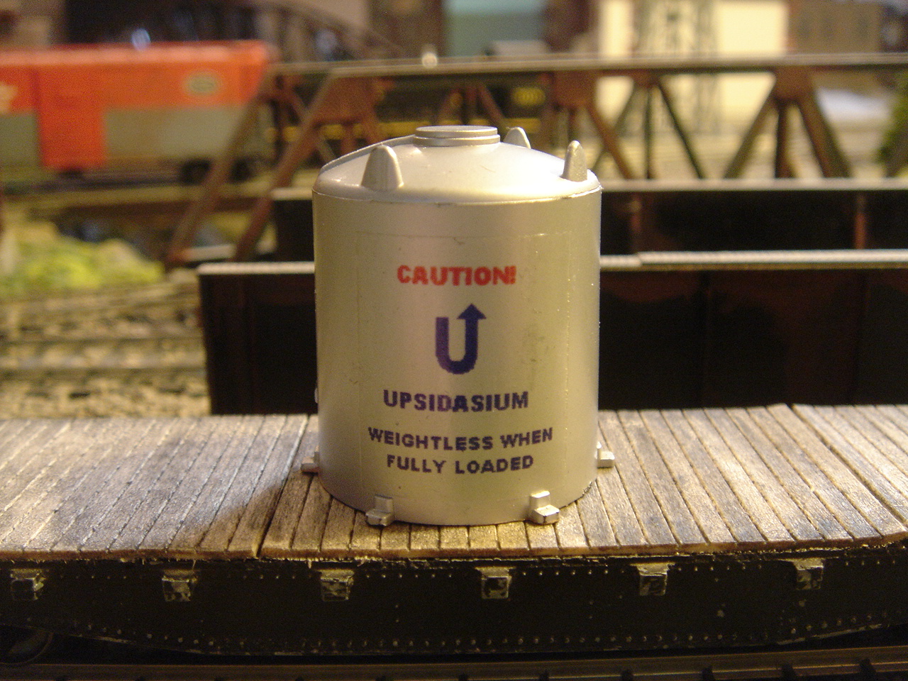

Also, “ore” doesn’t have to be iron. I don’t have a mine, but I’ve added cannisters from this odd material, Upsidasium, the anti-gravity element only found on old episodes of Rocky and Bullwinkle.
