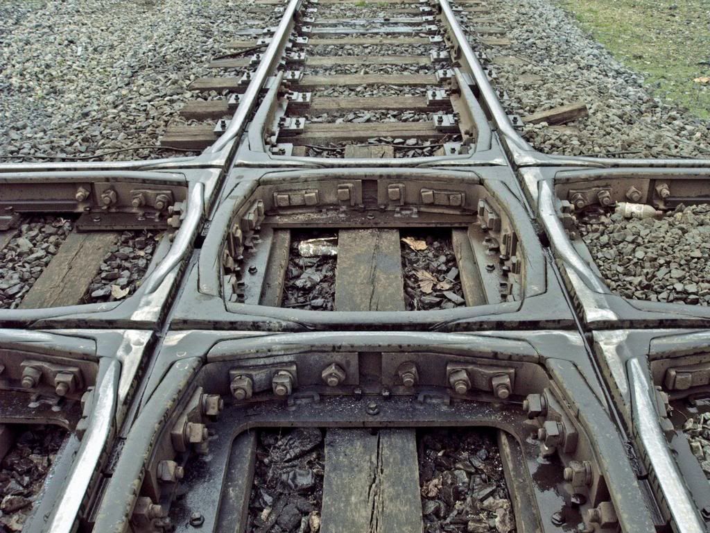

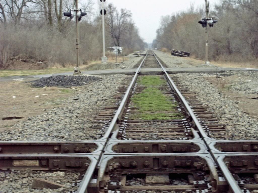

The frogs are one piece and all the same code in each direction. This is a pretty old diamond and some spare parts sitting a few feet away. Notice how the rails are angled next to the frog and the webbing at the 90 degree points. Interesting, huh?
Impressive, Philip. Thanks for posting the images. I have them saved.
Never seen the like.
-Crandell
Those pics were taken in Alexandria, Indiana.
Thanks, Brother Philip.[bow]
You’ve made my point as well. The two crossing tracks are both considerably lighter rail sections than the crossing itself.[8D]
