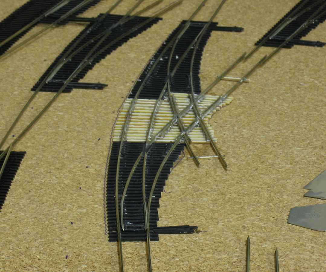

Just finished laying out the double crossover between curved main tracks at the entrance to Minamijima (passenger staging) on my double garage filler. All tracks are 610mm (24") radius, with easements. All four turnouts are curved, as is the crossover. Once the necessary subgrade/roadbed is in place I will assemble the track, using code 100 Atlas flex and raw rail on wood ties. No commercial turnouts, no jigs, no track geometry compromises, no problem.
The best part is that I don’t have to search the world for, “Close, but no cigar,” products that might have major hiccups in the future - totally unacceptable on track that will be hidden and very close to inaccessible once the visible ‘roof’ goes on.
Hand-laying specialwork isn’t for everyone - only people who are willing to pay attention to detail, use a couple of track gauges, a file, spiking pliers and a soldering tool to free themselves from catalog searches, backorder notices and not quite what was wanted trackwork. Added bonus - it’s a lot less expensive than store-bought.
Chuck (Modeling Central Japan in September, 1964 - with flex track and hand-laid specialwork)

Central Valley turnuts are curvable ! I did so with my Diamond Valley module.
And you have the choice of scratch building!
Wolfgang
