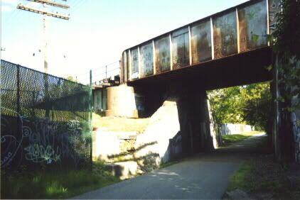

Ed, FWIW, there was more undesirable about that C&O line than just La Crosse.
Take a look at the low clearance in the photo below, where said line squeezes under the former Big Four main through Muncie. The former C&O line is now the asphalt bike path (Cardinal trail)…but when you see in person how short that clearance is, it makes one wonder what people could possibly have been thinking when they built it. If you climb up behind the retaining wall on the left hand side, you actually have to stoop over to climb in underneath the bridge, it’s so close
And to the left of the dirt berm is the White River, paralleling the C&O bike path with the normal water level not much lower than the path height… Even digging a trench to set the tracks deeper probably would be best avoided, because it would be flood prone.
Just eyeballing the clearance, it looks like a very standard boxcar would clear the opening, no hi-cube for sure.
There used to be more of a dip under the Big Four at Muncie, they took some of it out when they built the bike path. Trouble is, it used to fill up with water on a regular basis. The C&O of Indiana had both clearance issues and grade issues, climbing up out of the Wabash River Valley at Peru was quite a task for both the C&O and the NKP Indianapolis-Michigan City line. The clearances under the N&W (NKP) at Muncie and under the PRR at Richmond also would have had to have a great deal of work to run todays’ trains. I understand the B&O across Southern Ohio was abandoned as much for lack of on-line business as anything. Shortsighted? I think so but that’s just a personal opinion, I wonder what NS wishes it had back. Do any corporate people really think they would use the old Cloverleaf to St. Louis from Frankfort or the LE&W line from Fostoria to Muncie that was sold off and leased west of Lima to the Ohio/Indiana state line? I don’t really know but I’m fairly certain they don’t miss the Wheeling much.
